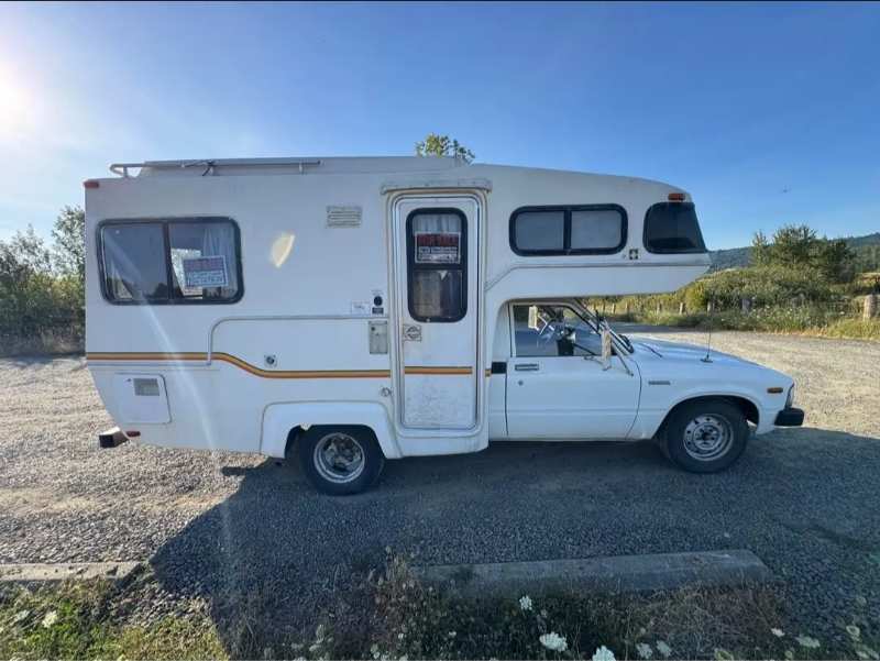

oldfartsoverlanding Posted August 30, 2025 Posted August 30, 2025 Any one local have a 1 ton 6 lug dually for sale. I am in Toutle Washington. I bought a 84 sunrader at it has the 5 lug fooley would like to get it swapped out. Unless anyone has any other recommendations. Have a smiling good day Quote

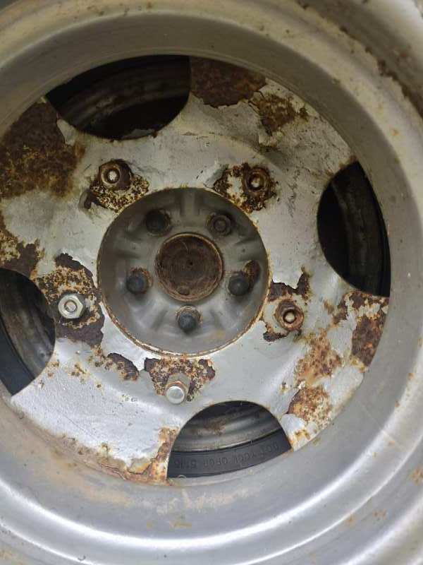

linda s Posted August 30, 2025 Posted August 30, 2025 Nah same old Toyota axle is strong enough with single wheels. The duallies are the problem Linda S I would like to see a close up pic of that rear wheel hub. Quote
oldfartsoverlanding Posted August 30, 2025 Author Posted August 30, 2025 15 minutes ago, linda s said: Nah same old Toyota axle is strong enough with single wheels. The duallies are the problem Linda S I would like to see a close up pic of that rear wheel hub. I will get a picture when I get back home later today and post it. For you Quote

oldfartsoverlanding Posted August 31, 2025 Author Posted August 31, 2025 On 8/30/2025 at 8:33 AM, linda s said: Nah same old Toyota axle is strong enough with single wheels. The duallies are the problem Linda S I would like to see a close up pic of that rear wheel hub. Quote
