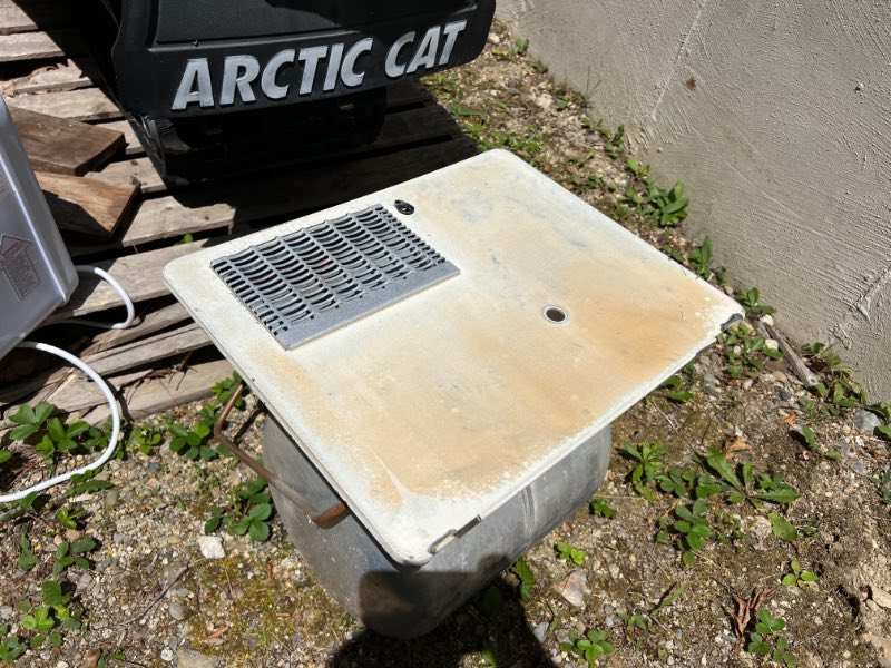

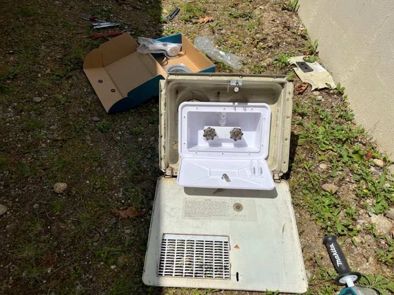

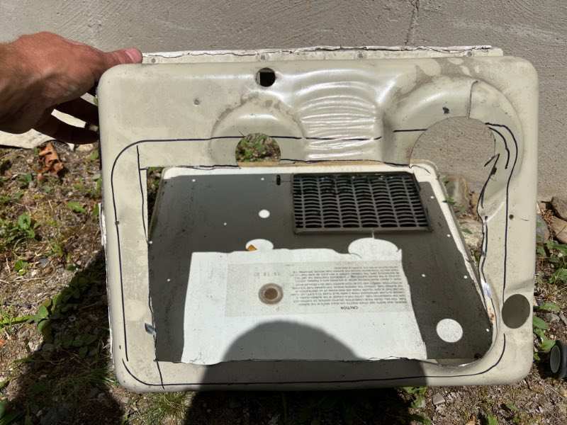

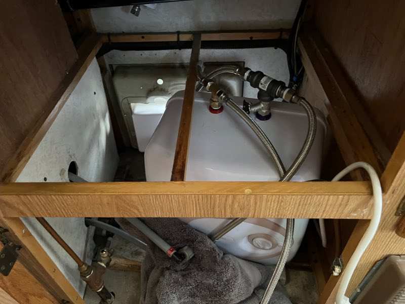

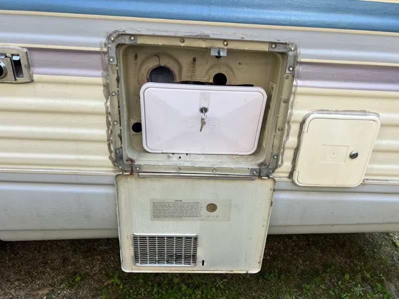

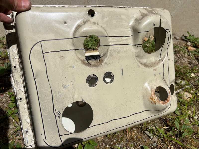

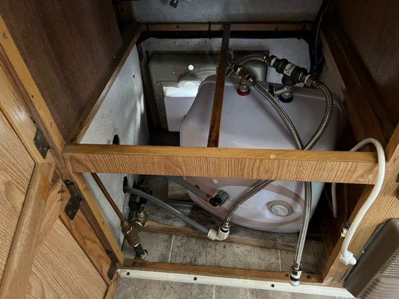

MaineJed Posted July 22, 2025 Posted July 22, 2025 Wanted to switch to an electric HW heater since all the places we camp have hookups and I torn out all the propane lines etc. while I was at it i wanted to put in an outdoor shower to clean my feet off so the wife will keep me around. I kinda rigged the shower to fit inside the access door that the HW heater was hooked to. Quote
