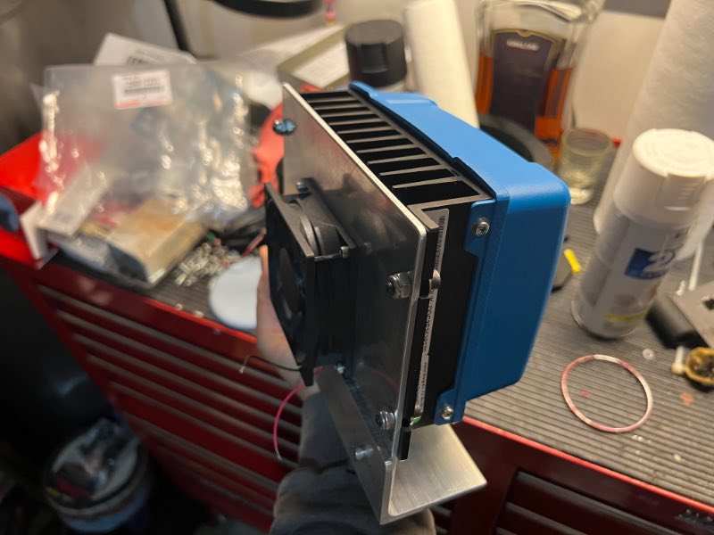

Ssunrader Posted June 24, 2025 Posted June 24, 2025 I’m mounting a fan on the back of my Orion charger, have to run another wire for that unless I decide to make a thermo-switch circuit. Also picked up a ‘94 Jaguar alternator, same plug on the back, 140A, added some beefier cables between the battery/alternator/frame. Quote

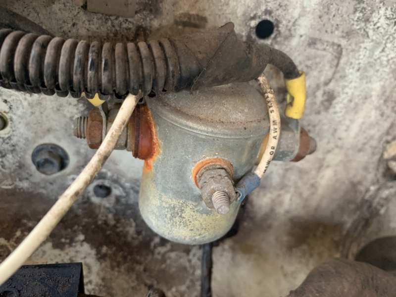

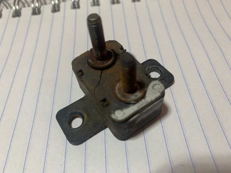

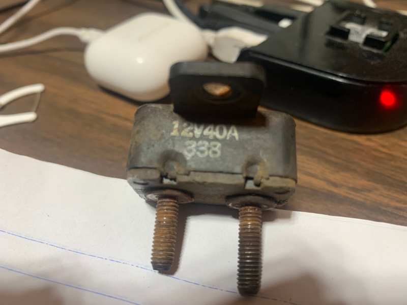

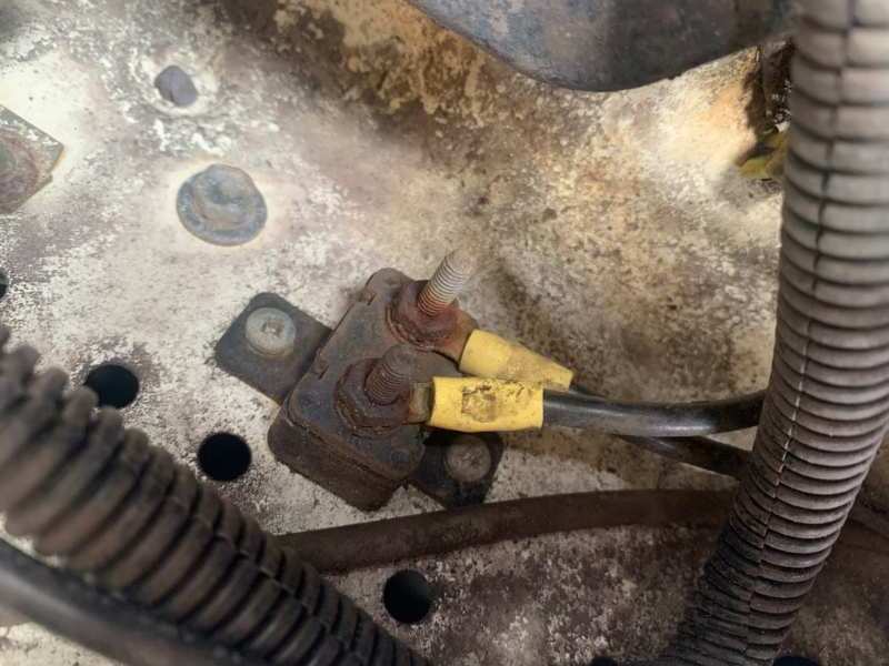

ATXBreeze Posted February 21 Posted February 21 Trying to replace the isolator on my 1989 Toyota MicroSpirt, 6 cylinder, 3.0L VZE. Pics are of the isolator's original mounting, unmounted, part number, and and potential Redodo* replacement (found here at the Forum). If anyone can confirm the Redodo will work AOK. *Redodo 12V/24V 150A Adjustable Dual Battery Isolator (VSR) - Auto Connect/Disconnect Starter and House Batteries, with LCD Display Thank You! Quote
WME Posted February 23 Author Posted February 23 Thats not an isolator, it is an auto reset circuit breaker. it is toast, so your real isolator is not working. MOST RV of this vintage the isolator looks sorta like a 35mm film can. https://www.ebay.com/itm/281238740295?_skw=rc+battery+isolator+solenoid&epid=0&itmmeta=01KJ5N4DG3KR1D0F0SRA9YXQSM&hash=item417b229d47:g:VOAAAOxy4t1Seae0&itmprp=enc%3AAQALAAABAGfYFPkwiKCW4ZNSs2u11xCCI83w2apaI5BD%2F0TjPS4odNTxpMTor4Zpdm6zXRwufdY3FLlv6LOWyWCepY254Wudzz9HtLmw9wQwiSrf6%2BQmaYd%2BzoWvUCmt80H4wHRR5lRpVv%2BfLatxQNCMlIz%2BmUejuRRZKqcFtZK2V0l9ELNjcz1ZMzKuSbMOo8o%2B%2B1sRZM%2FgVTb7KbmcTpXoh77DOQ%2FAIbg1ryzcMTHJAkCNC7UZ%2B6RfwVvQ%2FjnT74TyBNnro8Zyy86pDVrSoUUjGg2PrzSf5juiX5FLmWsshm9Snibcdwfc7wwTXIjj27vUXg8eOSKKBTuuFhpGMMq7zjHSAXc%3D|tkp%3ABk9SR57YkbWRZw If you understand the program for the Redodo its perfect Quote
ATXBreeze Posted February 23 Posted February 23 Yes, I isolated the isolator. Replaced the circuit breaker, see if this resolves the house battery issue. If not, will move on to the isolator. THX Quote
Gulfstream Greg Posted February 23 Posted February 23 Those solenoids are common failure devices. Also back in the day they classified them as a isolator but it is only a isolator when the engine is shut off. When the engine is running and the circuit is charging it is no longer a isolator. The coach or starting batteries can become over charged or under charged. I suggest replacing it with a modern smart isolator. Quote
