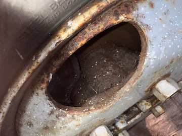

thewanderlustking Posted March 23 Posted March 23 (edited) That is WAY more than you need. The hard parts to get are the spindle extensions on the front, and a full set of matching wheels. All I did was take the brake hose off the caliper, pop the tie rod off, then unbolt the balljoints, and took the whole spindle/brake assembly. I probably took the extension thing off to lighten it up some. There was one gotcha when I got home. The balljoints, I'm not sure if it was one or both, had to be popped off the spindle. I think I had to remove the caliper and the bar the tie rod bolts to do this. But it wasn't a big deal. It took less than 45 minutes. As far as condition, well you "should" replace the expendables anyways. Brakes, balljoints.... Once you get into it, it's super easy to figure out. I read a bunch of threads and overthought the whole process too as I was going to try and replace it all with new parts. But getting those dually extenders for the front is impossible. So when I found the truck I wanted them off, it was so simple to just take the whole spindle and sort it out later. There is one small catch possibly to this swap. The calipers are bigger, a bonus. But the master cylinder should be switched out to match. I swapped mine out. Edited March 23 by thewanderlustking Quote

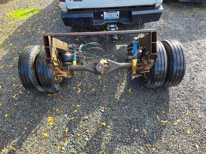

fred heath Posted March 23 Posted March 23 The rear axle with wheels is hard to find. If you have the room to store it, the assembly can be worth up to $1K. People are always looking for this item. Try advertising the rear axle with wheels on eBay or FB marketplace. Quote
RaderDog Posted March 23 Author Posted March 23 2 hours ago, RaderDog said: They also have a complete rear end. I wish I could. Quote
RaderDog Posted March 25 Author Posted March 25 On 3/23/2025 at 9:19 AM, fred heath said: The rear axle with wheels is hard to find. If you have the room to store it, the assembly can be worth up to $1K. People are always looking for this item. Try advertising the rear axle with wheels on eBay or FB marketplace. There are actually two rear ends here in the Portland, OR area. Here is the listing for the other. https://portland.craigslist.org/clk/pts/d/longview-toyota-motorhome-rv-dually/7826127689.html Quote

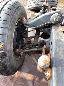

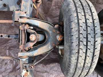

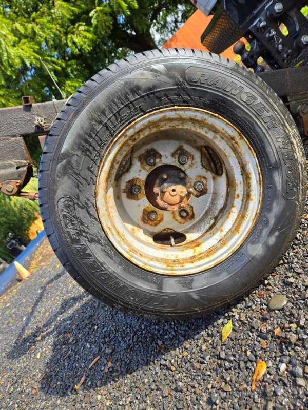

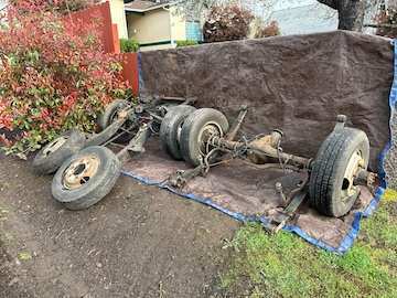

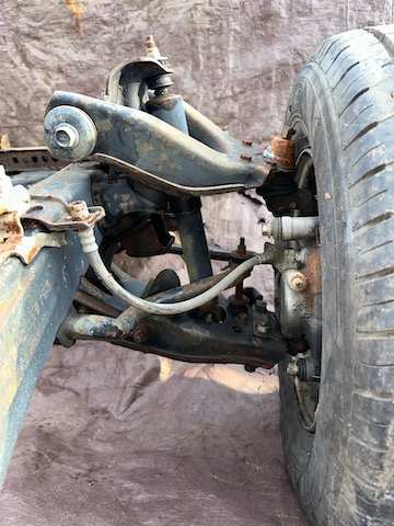

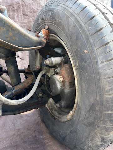

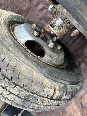

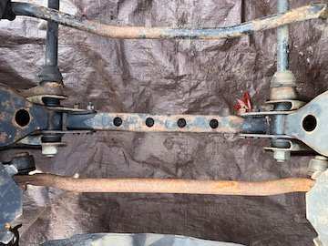

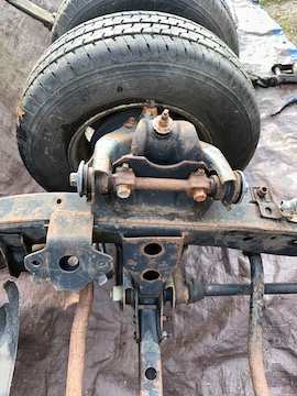

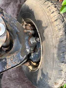

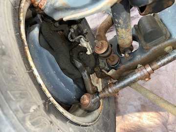

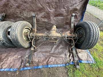

RaderDog Posted March 30 Author Posted March 30 First of all I want everyone to know that I went through a ton of the post on the site regarding this subject. I went today to see the Front and Rear end. It was purchased in a Foreclosure sale. The vehicle was not there only the frame but he was told it was from a Toyota Motorhome. The owner is a mechanic and is very willing to work with me on it. I am using the photo below posted on the forum for a 6 Lug Front End Replacement. I understand the parts that will have to be replaced (Bushings, Brake Parts etc) during the install. There is a 1 Ton Rear End that is available for free (don't have room to store). I have included a photo of both pieces below. I appreciate any help you all can be. Quote
RaderDog Posted March 30 Author Posted March 30 Here we go. The owner is willing to take apart the Front End and give me the parts I need. I just want to make sure of three things. 1) Is it the correct Front End for my 1986 Toyota SunRader (The Rear End was replaced under warranty. I have the Paperwork from the Dealer that did the work. So I don't need the Rear End). 2) Does the condition of the Front End look acceptable? 3) Are there any parts I should take additionally to have a successful swap? (Once again I am going off the photo above posted on the site for reference) I will be taking all six wheels and tires and sell my existing set. Quote
MaineJed Posted March 31 Posted March 31 This looks like a gold mine to me, It will fit your front end yes. Take as much as you can store, they are getting harder to find. Take the wheels at the very least Quote
extech Posted March 31 Posted March 31 i would take the upper and lower control arms with the spindles. save the alignment shims from where the upper arm mounts. if the center link is there take it with any other linkage Quote

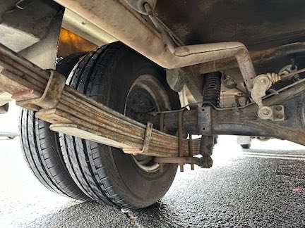

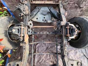

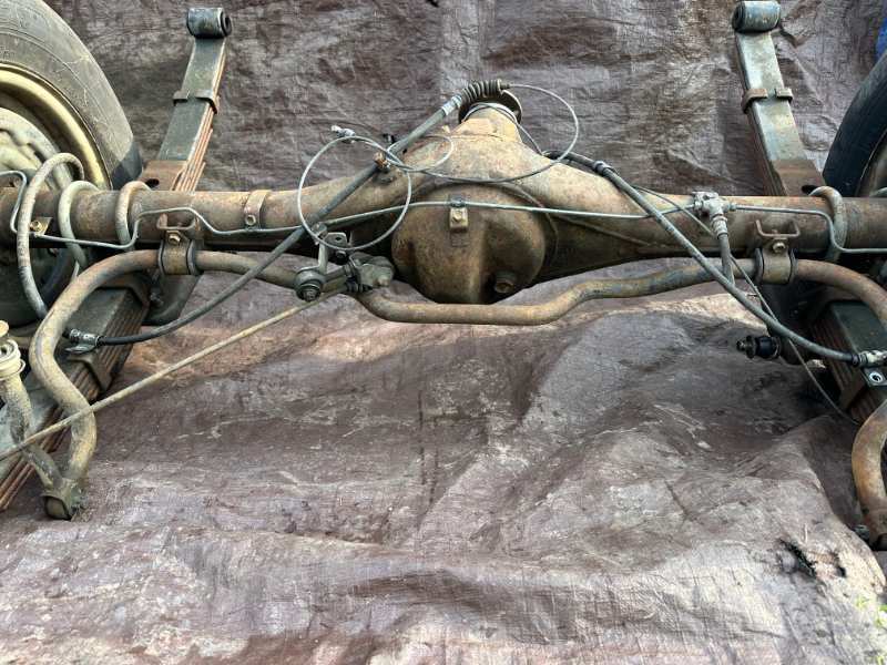

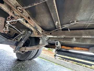

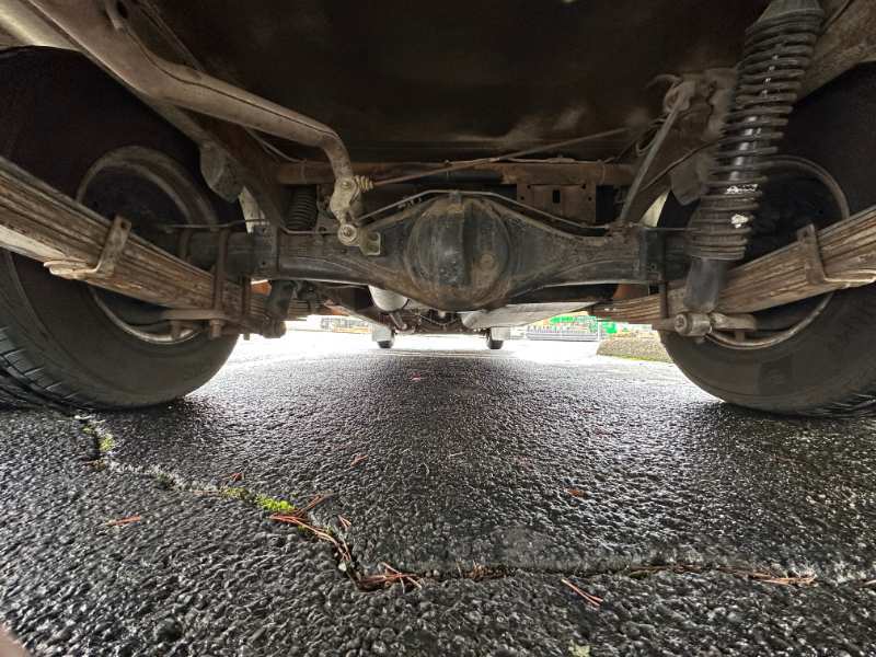

RaderDog Posted April 3 Author Posted April 3 I have a question regarding any parts I should take from the Rear Axle. There is a bar that runs side to side that is not on mine. Thanks. Top photo is my rear axle. Quote
linda s Posted April 3 Posted April 3 That's a sway bar and they make a huge difference in how your rig handles on the road. Grab it. Can't figure out why your rear axle looks so different. Maybe someone else here will know. Linda S Quote
extech Posted April 3 Posted April 3 i don't see the sway bar end link mounts on your frame. should be a tab with a hole welded to the frame. might be there . just cant see. the two axles look the same to me Quote
linda s Posted April 3 Posted April 3 Looked again and I do see the mounts for sway bar. Look to the left on the axle and there are 2 empty holes there. On the right they are there but it's dark and hard to see. You should grab them for sure. Linda S Quote

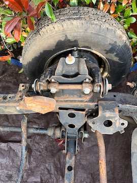

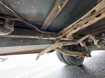

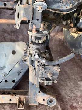

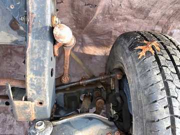

RaderDog Posted April 4 Author Posted April 4 (edited) Here are a couple photos of those holes. In my Renovation Adventure I have learned to take a lot of photos so I don't have to keep goin back out and lookin everytime I need to figure something out. Thanks. I also have included another angle of the Rear Axle I'm going to leave (without wheels and sway bar so far) Edited April 6 by RaderDog Quote
RaderDog Posted April 4 Author Posted April 4 (edited) I really appreciate the help. With the renovation I don't really have room for more parts at the house. I wish i could just take it all. I just want to make sure I don't miss something and have to find it later. Here is what I'm going to take the rest the Owner is going to take to the junkyard or metal recycler. Here is what I'm going to take so far. 6 Tires and Wheels My plan is to Sell the 4 that are on my SunRader (they are in better shape). These I will have Les Schwab sandblast and repaint probably Black. Front End Upper and Lower Control Arms with the Spindles Alignment Shims from where the Upper Arm mounts Center Link and any other Linkage Rear End Sway Bar ??? Edited April 6 by RaderDog Quote
extech Posted April 4 Posted April 4 for sure the sway bar. really worth having even if you have to have someone weld the end link mounts on. also i noticed your exhaust pipe is kinked where it goes over the axle. can't let that be Quote

RaderDog Posted April 6 Author Posted April 6 On 4/4/2025 at 12:15 PM, extech said: for sure the sway bar. really worth having even if you have to have someone weld the end link mounts on. also i noticed your exhaust pipe is kinked where it goes over the axle. can't let that be Here is a better photo of the exhaust pipe. I don't think it is kinked. Thanks. Quote

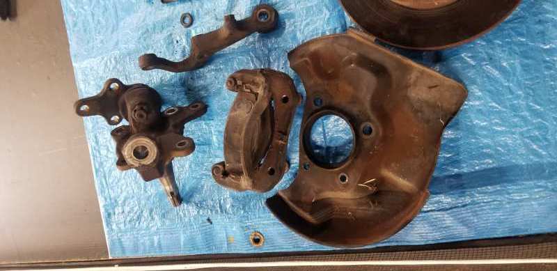

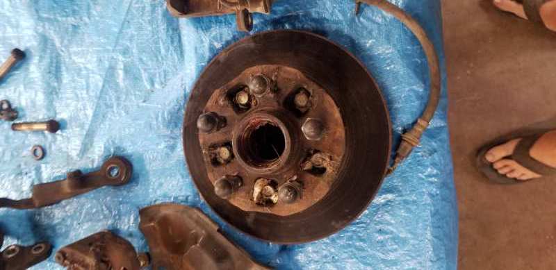

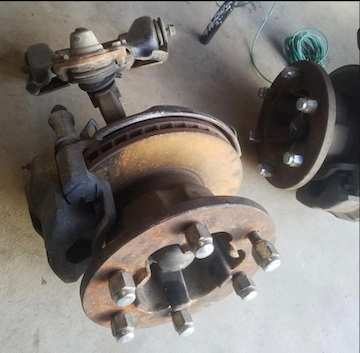

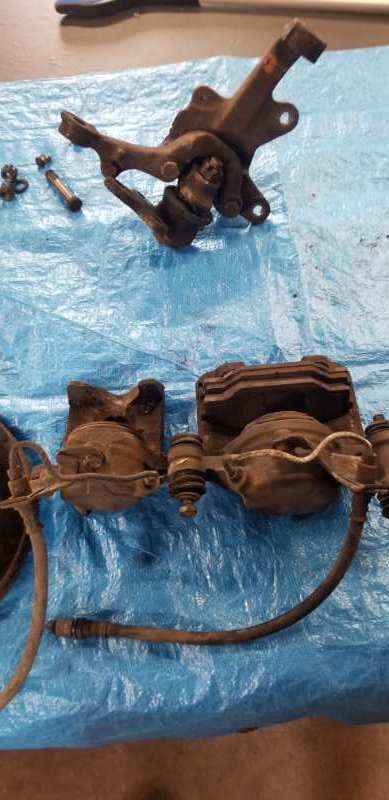

extech Posted August 24 Posted August 24 found some pics from when i swapped mine you can compare calipers, caliper mounts and dust shields. can't see the difference in steering arms Quote
RaderDog Posted September 3 Author Posted September 3 On 8/23/2025 at 5:10 PM, linda s said: I don't remember anyone changing out the entire front end. They just replaced the wheel hub Linda S Linda, I always appreciate your feedback. I have gone though the entire site for Info. I think I have most of it figured out. I am terrified of the day all the parts arrive. I read this one again. Thanks. Quote
RaderDog Posted September 3 Author Posted September 3 On 8/24/2025 at 2:29 PM, extech said: found some pics from when i swapped mine you can compare calipers, caliper mounts and dust shields. can't see the difference in steering arms I appreciate the pix. Thanks. Quote
