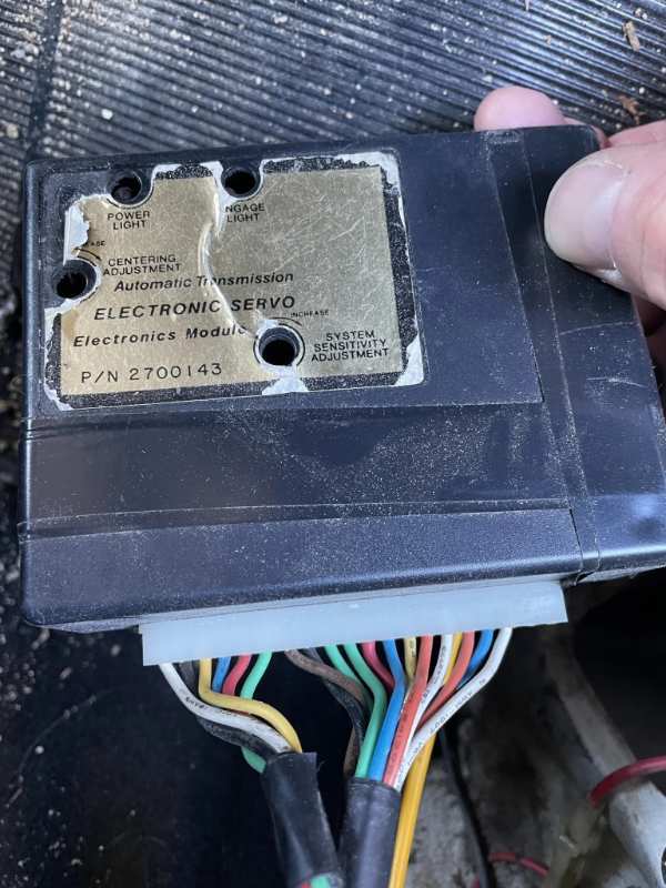

RaderDog Posted March 3, 2025 Posted March 3, 2025 A cover fell off while I was driving. This was underneath it. Does anyone know what it is. Thanks. Quote
RaderDog Posted March 3, 2025 Author Posted March 3, 2025 Sorry. I don’t know why this photo is posting upside down. I tried flipping it. Quote
linda s Posted March 3, 2025 Posted March 3, 2025 If it's on the inside passenger lower panel it's you engine computer Linda S Quote
RaderDog Posted March 3, 2025 Author Posted March 3, 2025 No drivers side. I think it may be either an old school TCM (transmission control module) or cruise control. Quote

linda s Posted March 3, 2025 Posted March 3, 2025 Found pic of same part on toyotanation. Other posts show members don't think it a factory part. You may be able to find more info from the part number on this one Linda S Quote
RaderDog Posted March 3, 2025 Author Posted March 3, 2025 I did a pretty extensive web search previous to posting. There are a number of them on eBay for both Automatic (mine) and Manual transmissions. I was hoping someone here had personal knowledge. I’ll keep hunting. Thanks. Quote
RaderDog Posted March 3, 2025 Author Posted March 3, 2025 It’s a pretty big harness so it must be important. Quote
Ssunrader Posted March 4, 2025 Posted March 4, 2025 I haven’t dealt with it myself. Kickdown or converter lockup control perhaps? Maybe that circuit helps hold a lower gear longer, prevents constant shifting up/down. Quote
RaderDog Posted March 21, 2025 Author Posted March 21, 2025 Mystery solved. It is a aftermarket Cruise Control. Has a lot of wires. The Cruise Control does not work. Not sure if I should buy another and switch it out. Not sure exactly how Cruise Control works on an older vehicle. I would be nice though if I could get it working. IMG_1566.HEICIMG_1681.HEICIMG_1565.HEIC I found the replacement on eBay. Not a lot of info on the web but here is what I found. Here is some more info if anyone has any opinions/ideas. Thanks. ARA Automatic Transmission Electronics Servo Module 2700143 https://www.ebay.com/itm/146372720384?mkcid=16&mkevt=1&mkrid=711-127632-2357-0&ssspo=i3uKZzCWTrO&sssrc=4429486&ssuid=bdWCT_rLSti&var=&widget_ver=artemis&media=COPY https://www.thesamba.com/vw/forum/archive/index.php/o-t--t-380099--.html Quote
thewanderlustking Posted March 23, 2025 Posted March 23, 2025 (edited) The old modules like that are pretty bulletproof. I would start with trying to find installation instructions. They should have troubleshooting info, hopefully. If unsuccessful in that search, do the obvious and check fuse, then eliminate those scotch blocks. If there is a failure, it is most likely in the installation and those are going to be the first things to fail. Another thought, find any installation instructions from back in those days for cruise control, and you will get a pretty decent idea of what the parts are and what you are looking at. Edited March 23, 2025 by thewanderlustking Quote
