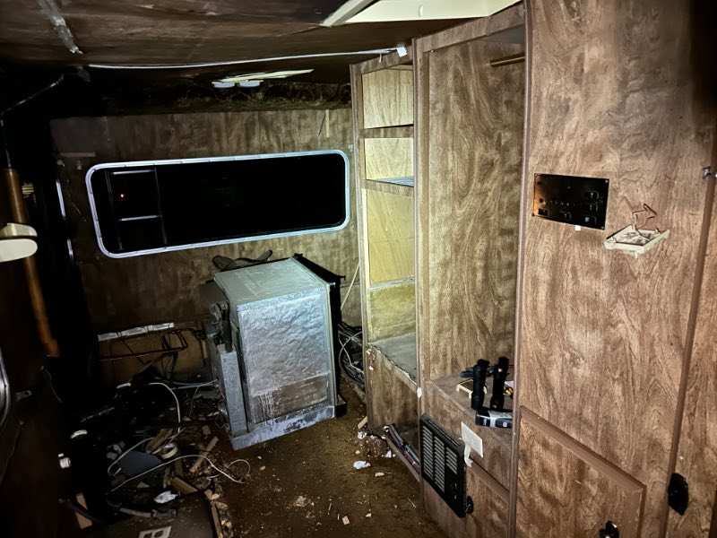

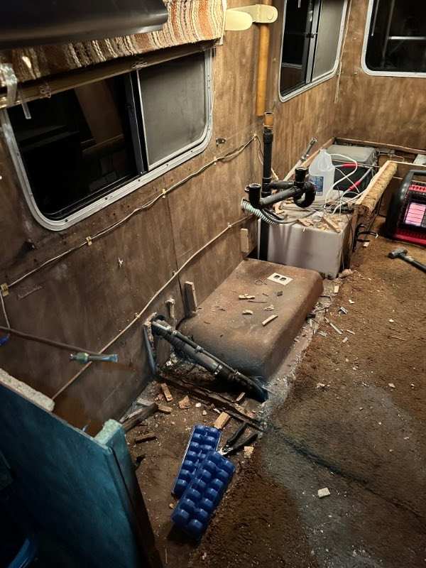

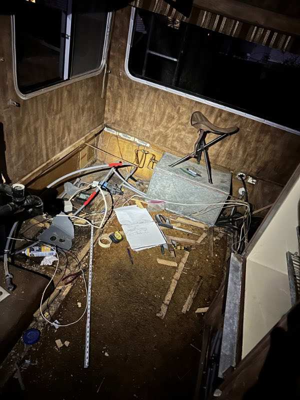

So tonight I only had about 90 minutes to mess with the Sunrader.  Removed the upper cabinets all the way around, pulled the entire electrical panel/power supply/converter out (wow - surprisingly heavy - bet it's replacement will be 1/4 the weight!), pulled the fridge out of it's hole and tried to remove it.  Nope - won't fit out the door.  I've seen others cut it up, but um...I have to put a new slightly larger one in, so I'm going to try removing the passenger seat in the cab and getting it out the passenger door.  This will give me a sense of how much bigger of a fridge I can put in it. Hoping for 4.3 cubic feet/45" tall - any suggestions?  Looks like Norcold has abandoned this size segment but Dometic still makes them.
In the photo below, you'll see I have been carefully preserving the copper LP lines because I was thinking I'd be reusing them.  However, I just found a few minutes ago that time has passed copper by and now people are using black and yellow flex hose for LP.  A great relief for me, so next pic all the copper will be out and headed to sell at the scrap yard.
I'm over "feeling bad" I started getting destructive and just smashing things out as that's not my style. But I'm realizing there is nothing for me here that will be reused in terms of cabinetry, window blinds, shelving - nothing.  When I get to the bathroom (tomorrow I expect) I will stop and be careful as I will be keeping that, though likely removing the cabinetry around it in favor of whatever I build in the rest of the living area.  I'll also need to move the bathroom unit around as I want to check the floor under it.  I really hope I'm correct that I can disconnect it and drag it around as I work on various floor sections, then drag it back into place and resecure it.  I will be bummed if I cannot do that without breaking it or tearing it up.  It's not that I'm afraid of tackling an all new bathroom, but in all my vehicle restorations, I like to have something from the past remain and I chose the bathroom enclosure.
I am working by headlamp these days, and using a portable electric heater to take the edge off the 24 degree outside temps where I'm working on it among some trees on the side of the house. Was great using the original furnace, but now gas lines are disconnected and electrical as well, so that benefit is gone. So here it is this evening:
Fridge and closet doors off.

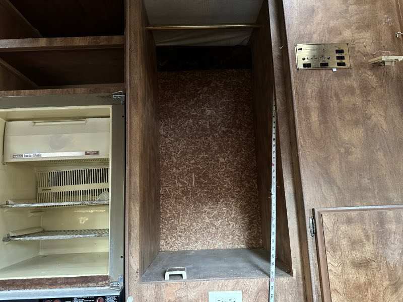

Great news.  I will part out the Dometic fridge.  It's likely not been used much at 32k miles.  Unfortunately, it kept catching fire when I started it on propane, so that alerted me to the many downsides of having 40 year old appliances.  I'm not made of money but the camper remodel will include all new appliances to avoid problems and make using the Sunrader more pleasant.  I think the heater will stay, but not sure until I pull it out and have a look.  Worked flawlessly for many hours and would help satisfy my "something new and something old" penchant for restorations. Today, I am hoping to finish pulling the interior completely apart, including the ceiling to fiberglas.  I'm really looking forward to that part as I need to physically see if my plan to bow it upward and reinforce it will work.  Wish me luck today - big day.
Well, I got everything else out of it except the bathroom, ceiling and wall paneling.  The fridge indeed fit out the passenger door - thanks.  Had to pull the driver's seat as well just to prevent snagging from the fridge's sharp edges, etc.  Here's where she sits as of now:

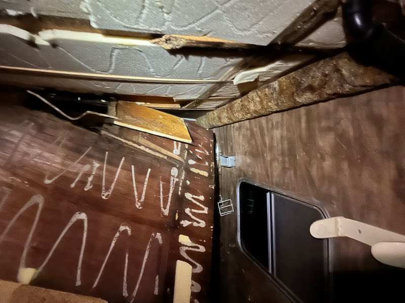

The floor is wavy and it looks like the wheel wells have majestically risen up into the floor a half inch or more, so I'll be looking at what's going on there, and what it will take to correct that.  Won't be messing with the ceiling just yet.  Need a flat and strong floor to use my roof jacking strategy.
The inside of my dolphin seems as well maintained as the cab/chassis so I’m hoping I won’t be doing a complete remodel any time soon….

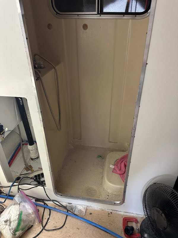

OK, had some drama (see separate thread "Does anyone know how the Sunrader bathroom unit attaches to the floor?" getting the bathroom disconnected. Turns out the thick black hard plastic toilet base held in with 8 screws simply unscrews.  Mine was covered with silicone, which I cut expecting to simply pull it and the tube straight up out of the black water tank.  But no.
Back on track, the bathroom unit is held to the floor via the aforementioned 2 day delay, plus the window frame if yours has one.  Once that's loose, it's just friction with the sagging ceiling that prevents you simply dragging it away.  I recently learned it will fit in the over cab bunk, which is great news for getting it out of the way.  Right now I have a bunch of cabinet doors and things there, so I'll confirm that at some point.

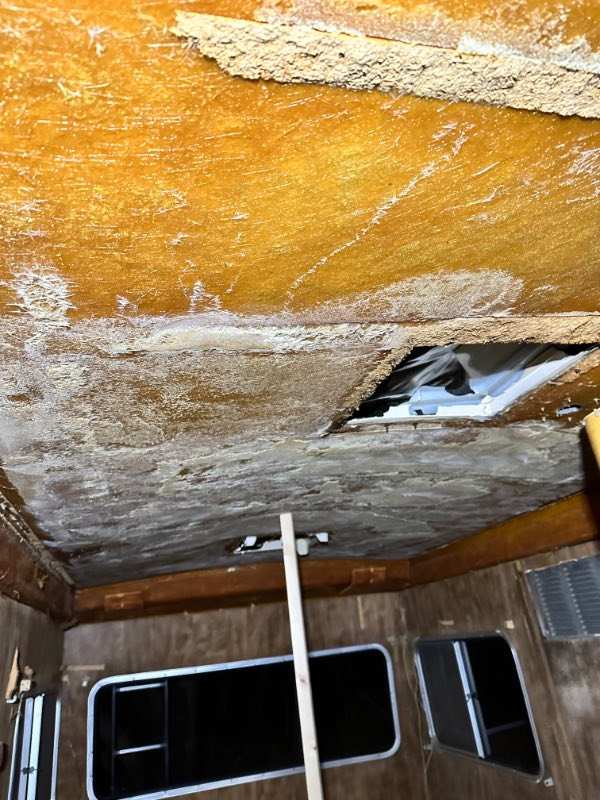

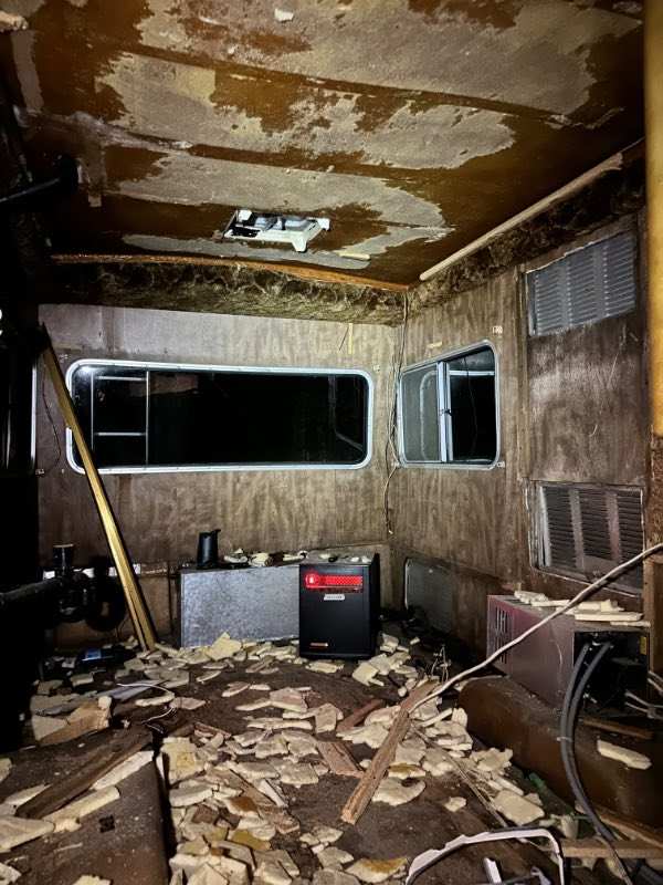

With the bathroom moved from its corner, I tore down all the ceiling:
image.jpeg.ee49168055dddbf4b8e9f197de257266.jpegimage.jpeg.3238c5630fc6ddbd330ab03122a06b9e.jpeg

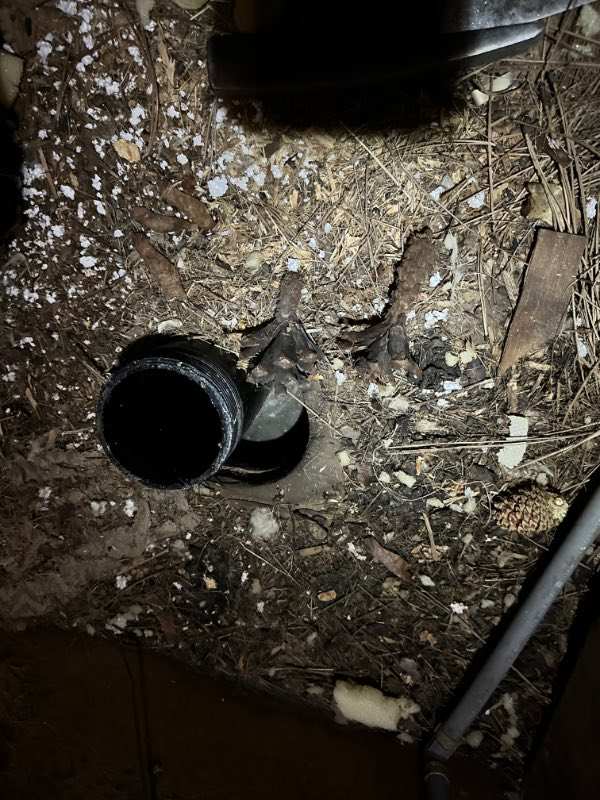

Discovered a HUGE opening under the toilet the manufacturer erroneously cut and didn't bother to seal, allowing some good size creature (packrat?) to comfortably live under there for however long.  Whatever it was, it was not a mouse as there was no poop or pee there at all.  Almost a considerate houseguest and he had a nice nest there, but no food or evidence of eating!  Mice will pee and poop constantly wherever they sleep, walk or eat. Anyhow, I'll be sealing this up with the new floor:
Here's where things stand as of tonight:
Probably a few more hours of tearing out remaining bits of wiring and scraping the ceiling, but I'm going to clean out the front bed, wrestle the bath unit up there with an extra set of hands, and then tackle the floor.  Some foreshadowing that the ceiling is very floppy and I hope will prove responsive to my re-arching and reinforcing plan.  Almost scary how floppy now without the layer of foam and the left side cabinets and bathroom holding it up somewhat.

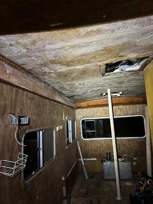

So, did not mess with anything further today but the roof as I've got to get it arched, stable, and winter worthy asap.  Last week I bought 4 joist jacks which you place a length of wood atop and then can screw to force the ceiling up with.  Just to see what's possible, I placed 3 of them down the centerline and put only moderate pressure on the roof, actually lifting the post at about 70% of my max strength and bringing the jack up under it to hold it.  Not using mechanical advantage yet.  I ended up with 6'2" down the centerline, which I'm really pleased with.  So, I'm moving on to buying rectangular aluminum hollow stock for the roof beams, which will press against that thick aluminum plate.  I'll need to find a way to gently arch them - shopping for a wheel bender this evening.  I don't want a shop to arch them as I may need to change the arch a bit depending on how things go as I start at the rear and go forward and the last thing I want is to find the single arch shape is all I have.
I plan to bed the beams all the way across the roof with a thick bed of 2 part epoxy, essentially making them into a single bonded structure.  I'm looking for 3/4" by 2" stock.  Of course, I'll sand and prep the roof surface (that's going to suck overhead and I have to do the entire roof as I'm also glueing Owens Corning Foamular to the ceiling between the beams and need a good bond there for strength addition) before epoxying.  The foam will add strength between the beams for walking on as well. Still unsure about beam spacing, but I'm going to err on the close side - perhaps only a foot apart the entire roof length.
I also ordered a two burner propane Magic Chef cooktop. Details later, but my plan is to shrink the length of the kitchen counter, but eliminate the cooktop.  So the cooktop will only appear when needed (what - .5% of the time when you're actually cooking?).  I'll reveal how I'm going to do that later but it's cool. So it's exciting to have the fridge and cooktop handled.  Next as we're eliminating the stove/oven unit, we'll be replacing it with a convection/microwave. Wow - expensive but I saved a bunch on the fridge so am still on budget.

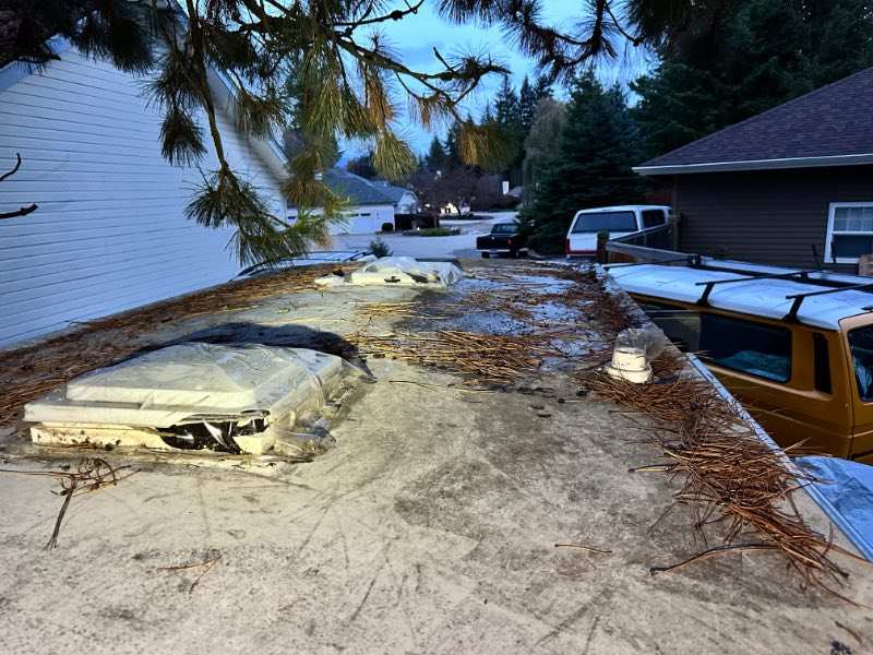

So, the roof is my current focus.  Here's how it looked before I touched it:
Here it is now with just quickly putting up the 3 poles.  The roof has a nice arch and the fore and aft ridgeline is nearly straight.  Yes folks, that's my work area for the winter up here 90 miles from the Canadian border. And that's our current "weekend escape capsule" - our restored 1988 VW Vanagon:
And here's an interior shot with the 3 jack/beams just pushed up by hand (no cranking yet).

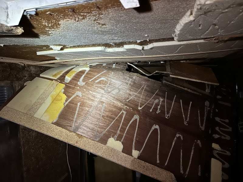

Getting the wood out of the corner up where the roof and walls meet was a pain.  The left side wood piece yielded to simple prying and popped out in several lengths to bare fiberglas.  The right one must have been installed by the better worker as he was liberal with the resin and I needed to use my hatchet being pounded with a hammer to essentially chop it away from the fiberglas to make room for the thick aluminum beam.  That beam will also do double duty as a strong base to mount an awning to later.  I'll try to leave access to it so i can drill through it and use real fasteners (stainless nuts, bolts, washers) to attach the awning.  Possibly also a roof rack will attach there.

Took about 90 minutes of carefully trimming a piece of 6 foot wide cardboard to the curve of the roof held up with 3 rams to get a nice shape I'd like to duplicate the whole length of the roof.  I then transferred the curve to 3/4" plywood and tomorrow will make the two roof rams.  Aluminum is supposed to be here Thursday.  Once I've got the curved beams, it will be a painful few hours sanding the roof to remove glue residue and some bits of resined on wood. I need not just the lines across prepped where I'll epoxy the beams, but 100% of the roof prepped as I'm also glueing up new foam after the beams go up.  Planning to use Owens Corning Foamulator, and this will also add strength to the roof between beams.  I will need to use a respirator and one of those disposable hazmat-like suits. Yeesh - not looking forward to the sanding.  Anyone have tips on what tool to use to sand the roof?
i have a pole sander with a vacuum attachment that works well. not too expensive on amazon.
Ended up using a rotary disc sander with 80 grit.  Did a nice job prepping the ceiling for epoxy and ribs, as well as the side wall tops where the side plates will go. Mostly done:

Today, I spent time up on top pulling the vents as their screws were preventing me from grinding the areas right around the openings.  Every screw head had to be picked clean before the square drive fit into it.  I'll tell you, this roof re-arch is turning into quite a project, but honestly I don't know how you'd fully enjoy a Sunrader with the hallway headroom of 5'10 or so.  Anyone who strips it like I did would definitely want to include this in their plans.

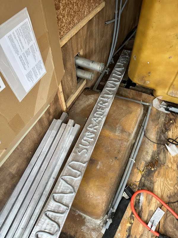

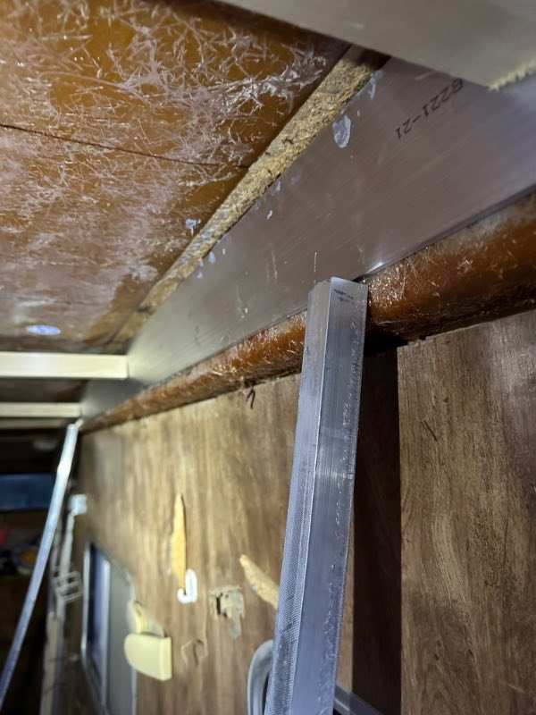

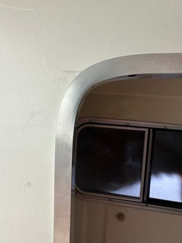

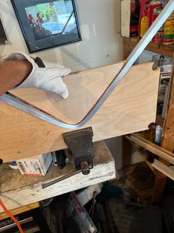

Speaking of the re-arch.  Here's the plan.  Using 1/8" thick walled 1X1 6063 aluminum square tubing, with 1/4" thick 6061 aluminum plates 4" wide and the entire length of the top of the walls - that first portion that drops directly off the ceiling.  The plates will prevent the point loading of a roof beam from being able to "spread" its ends and collapse and each beam end will press against these tightly. The beams will be bedded their full length in 2 part JB Weld slow cure epoxy what adheres equally well to aluminum and to fiberglas. My engineering buddies and I *believe* I will be able to stand on a single beam with a kayak, etc - over 200lbs of point load.  The spaces in between will have Owens Corning Foamulator fully glued directly to the fiberglas with a glue yet to be determined (even Owens-Corning's engineers refused to specify a glue by name while brightly saying "any glue that's compatible with it will work, grrrr). As from the factory, the foam will provide significant strength and the Foamulator is both a better insulator than other board insulators, and has the highest strength of them all.  I was already planning to use it in the walls, so finding that it's also perfect for the roof strength was an unexpected bonus.
I've now realized that the roof beams will not all be the same shape, due to variations in each Sunrader's structure, but also as you go forward there's less arch.  So, no point in having a shop bend these. Also, I've reversed my earlier plan of starting at the rear just by thinking through the bending procedure.  I'll bend it a little, go out and test fit, bend it a little more, test again.  Inevitably, some will be bent too far as you estimate the rebound after removing bending pressure to see what you've got.  If I start at the front, beams I bend too much will fit farther back where they need to be bent more.  Hope that plays out.
I have a buddy who's a talented welder and shop owner and he has a roller bender which is what I found through research is the right tool.  So, Sunday I'm driving the Sunrader in all its floppy glory over to his place 90 minutes away to spend the entire day bending and test fitting. I'll number them and come home to start fitting them at home as each one will take a day to cure.  I might be able to do 2 in one day - not sure yet. When each is fitted and bedded into epoxy, the ends will be trimmed to fit as tightly as I can, and be secured with both epoxy and a screwed on bracket into the thick side plate I'll make that will also be epoxied.  Last thing I want is 10,000 miles of vibration from now to hear a bolt fall off a beam and break my heart!
Hopefully there will be enough epoxy.  I bought $170 worth, but there's a lot of surface area here.  Fortunately, it's available all over town if I run out.  Speaking of money, by the time this roof re-arch is done I will probably have spent about $750 on it, though I would have done SOMETHING to re-arch it no matter what and strong enough to handle feet of Idaho snow.  My higher strength goal of walking on it, adding rooftop A/C, and possibly even mounting a small lifting device to help pull kayaks up is driving what I sincerely hope will be a VERY solid structure and doubled what I might have invested.  Frankly, it's all theory at this point, and I have nothing to go on but a rudimentary background in engineering and materials science.  Wish me luck, I'm in uncharted waters and keenly aware that things could go badly.....

So, an initial impression on the aluminum I bought.  I took a beam, rested the extreme tips on a couple books, and stood on the center.  I have a few extras and I kind of thought I might ruin it with a sudden collapse. To my delight, it flexed, but held my 180lbs without collapsing - a full 6 foot unsupported straight span.  It has a slight bend to it, which is fine as it will be bent further into a beam.  So when arched it will have more strength yet, and when epoxied to the roof more strength yet and supported by the foam glued to the ceiling next to it - a bit more strength.  So I think I'm going to accomplish what I wanted - a walkable roof.

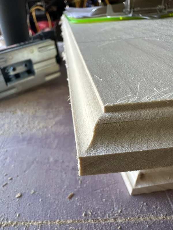

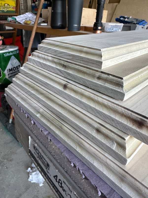

I'm trying to get something done each day, but yesterday was a bust as I couldn't settle on an adhesive till too late to work on it.  This evening, I just hung the first of the two thick aluminum wall plates the cross beams will rest against.  It needs 24 hours to cure, so tomorrow I'll do the other side.  I've got metal beams just holding it up, and 4 cross beams shoving the plates hard against the wall. Heaters running all night and I'm looking at the temp feed from the van out there and it's barely holding 48 against a 38 actual temp.  So during the night it will dip to the upper 30s, but the glue specs are good down to a remarkable 10F:
2nd side plate up and curing. I used Loctite's PL MAXX - a new generation construction adhesive that looks to be perfect for this application:
