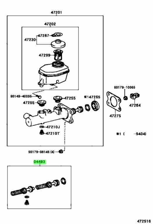

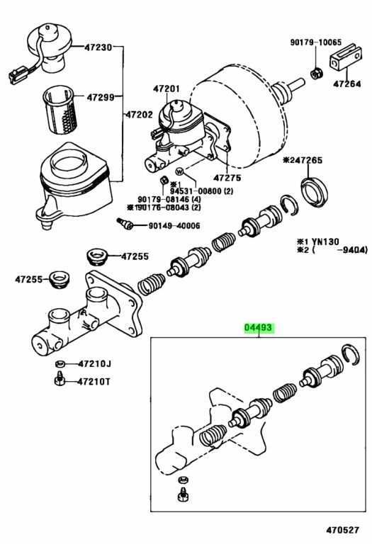

Elena Posted October 17, 2025 Posted October 17, 2025 Thanks so much, I found the perfect Master Cylinder and it's ready to go in. BUT - my Haynes says I will also need a repair kit. I think that's Toyota part - 04493-35260 Brake Master Cylinder Repair Kit, which I have found and ordered several times, only to have my order cancelled because the part is discontinued. It looks like pistons and hardware, to me. It also wouldn't surprise me if THIS is what needs to be replaced after all this time. Anybody know where I can find this? OR - can I get the individual pieces off the shelf by just using info like the bore diameter, thread size, etc? Is that how it's done? Thanks SO much. Pics of what's included in the original part number are attached. Quote
Ctgriffi Posted October 17, 2025 Posted October 17, 2025 What MC did you buy exactly? A new master cylinder doesn't need any parts—you just unbolt the old one and swap in the new, very straightforward (although follow the instructions for bench-bleeding the new MC, and then obviously make sure all brakes are bled thoroughly after the install). Quote
Elena Posted October 17, 2025 Posted October 17, 2025 Thanks so much, that is helpful info. SO - all those things must already be inside? I got this one (though I purchased via Rockauto). https://www.centricparts.com/brake-master-cylinder-130-44707 Elena Quote
extech Posted October 17, 2025 Posted October 17, 2025 yes the new one you listed has all the parts needed in it. one other thing to check is the interface with the pushrod in the booster. the pushrod should not push the piston in when the master cylinder is installed. Quote
