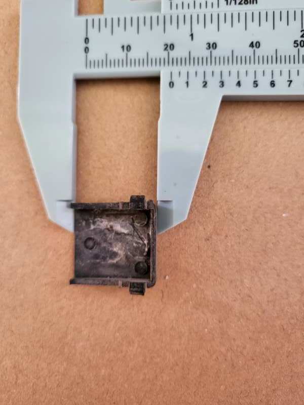

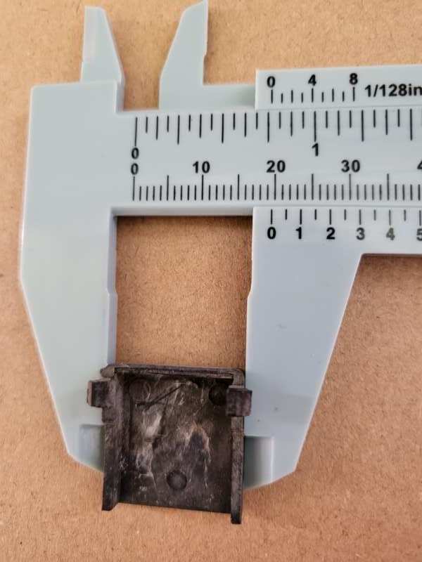

lucidawake Posted February 9, 2023 Author Posted February 9, 2023 Does anybody know where I can purchase replacement Weep Hole Covers for my Sunrader? The replacement ones sold by a forum member will not fit. The total width of the weep hole is 1 1/2" for the clips and the total width of the current covers are 2". Quote
linda s Posted February 9, 2023 Posted February 9, 2023 My weep hole covers on both of my Sunraders are very different from yours. 3/4x3/4. Tabs come out slightly farther to lock them in place. Search weep hole here and ask the the size of the 2 at the bottom of that page https://www.pellandent.com/ Linda S Pics are of mine Quote
lucidawake Posted February 9, 2023 Author Posted February 9, 2023 Thank you, Linda. I have reached out to the company that you provided. I'm not sure why I seem to have such odd ball windows Quote

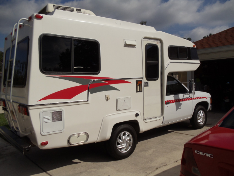

linda s Posted March 28, 2023 Posted March 28, 2023 My friend Roy's 87 nissan Sunrader for inspiration. Quote
Scott iv Posted March 29, 2023 Posted March 29, 2023 I'm not always a fan of hub caps, but those look great on that vehicle IMO. Quote
