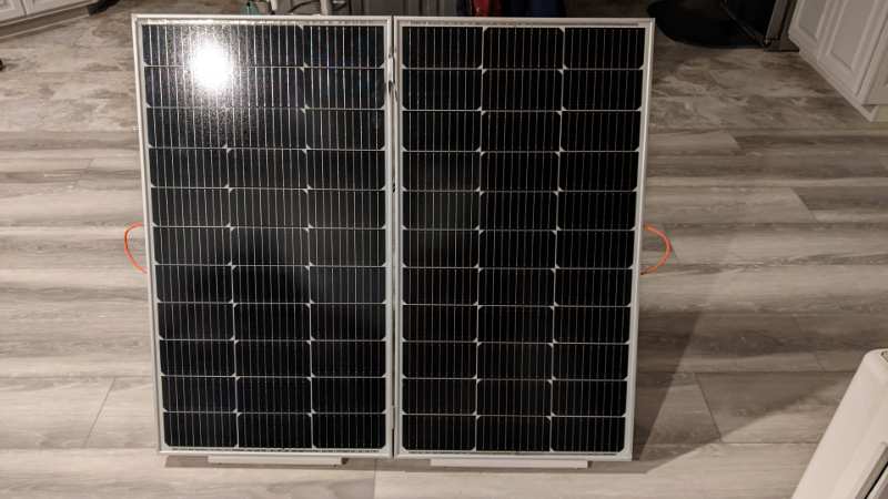

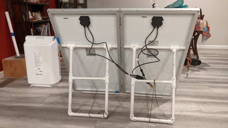

WME Posted January 3, 2023 Posted January 3, 2023 (edited) As an alternative to panels on the roof, this is my diy solar suitcase. 200w power and $200 all total to buy panels and PVC stuff. This isn't an original idea, but is from several utube ideas Edited January 3, 2023 by WME Quote
