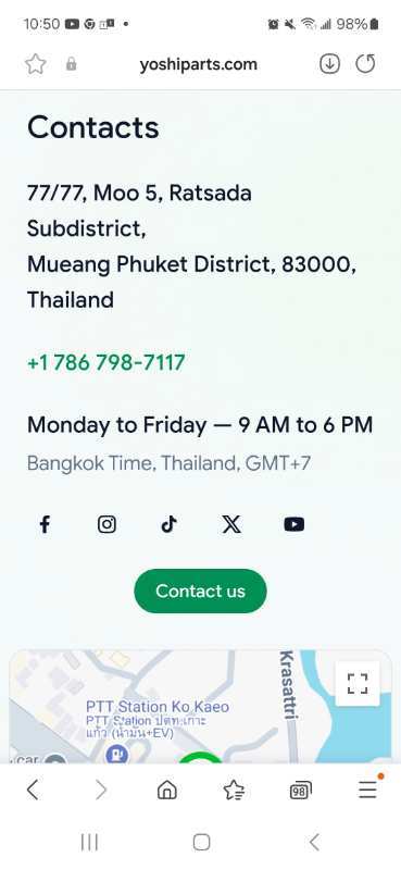

KC1 Posted March 14, 2025 Posted March 14, 2025 Just now, KC1 said: They have a Florida phone number but they ship Toyota Dually parts worldwide. Check this website and call during Thailand hours.. Quote
