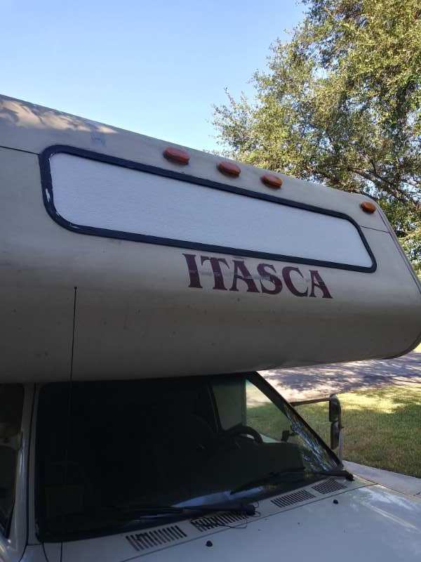

I've removed my front window, re sealed it with butyl tape, and caulked around the glass, and I still have a small leak in hard rain.   I'm tired of fighting with it. and I'm going to completely remove it.   I was wondering if anyone has replaced the front window with filon.    I could use some advice if anyone has done this.
by the way, I forgot to say that this is in a 91 warrior
 I thought about doing that but my dog loves to lie up there and look out the window. I sprayed around mine with some clear Flex Seal. No more leak. You can't really see it unless you look close.
When  rebuilding my 1991 I used a fiberglass panel from Home Depot. Inexpensive solution and no worries about a leaking window.
On my 1988 toyhome I used plywood first and replaced it a few years later with 1/2 inch pvc board.
I kept having a small leak on the driver side corner of the window and  I did everything that you mentioned above and finally figured out it was actually from one of the running lights above the window. Water was running down hitting the window and going around it so I would make sure those running lights are sealed up real good.

I used this from home Depot and haven't decided how to paint it yet
Glasliner    4 ft. x 8 ft. White .090 FRP Wall Board
https://www.homedepot.com/p/Glasliner-4-ft-x-8-ft-White-090-FRP-Wall-Board-MFTF12IXA480009600/100389836

I removed the window and used a mobile home siding to cover,  only available in white so need to paint.
