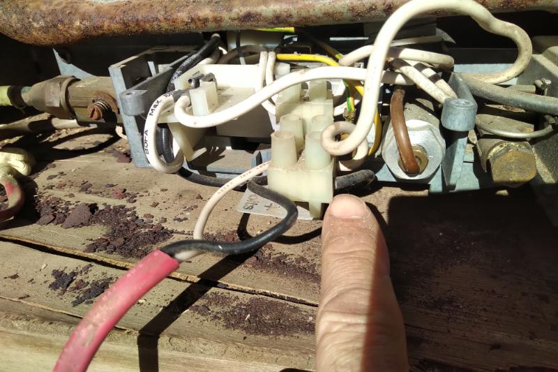

Trouble shooting my Dometic fridge. Works on propane and 120. Flame lights up on propane and heating element gets hot (very!) On 120. So no worries there. When I switch it to 12 volt I get power (12+volts) on both sides of the positive terminal in the back (See pic 1) but the 12 volt heating element doesn't heat up at all. No voltage on the negative terminal going to the heating element and no load showing on my battery status monitor. Ground is good. Bad switch? Bad element? Bad brain? Any suggestions?  I have included a picture of the wiring at the power center as well should that be of any use.

check resistance of 12 volt heating element. Specs are online somewhere. If it shot the are lots of options for replacement for not a ton of money. 30 to 50 bucks

Unplug the 12v heater and use an ohm meter to check resistance.  Open means it's burned out. 0 ohms is also bad. 1-2 ohms is good. This is a very low reading and requires a good meter.

Update to Linda S and WME. Thanks for your help. Checked the resistance and within the limits of my odometer, got good results. 'Not zero' for the element but not infinite either. Regardless,  the process of disconnecting and reconnecting all the leads seems to have fixed the problem. Now pulling 10 amps! I only use the 12 volt setting while rolling. Alternator was upgraded to 55 amps (from the stock 40) and seems to handle this extra load fine.

take the 2 wires(black and white) out of the terminal block.  check the resistance between them. infinate=bad heater element.
