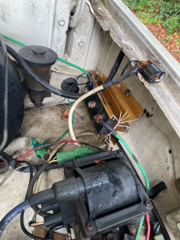

WME Posted November 12, 2020 Posted November 12, 2020 Is your isolator a solenoid type or a diode type? A diode type is a box with fins and 3 or 4 cable studs. A solenoid type looks like an old style 35mm can with 2 big wires and 1 or 2 small wires. It is possible for a diode type to charge the house battery and fail to charge the truck battery. IN an EMERGENCY you can bolt all 3 wires to a single post and run the engine off the house battery Quote
Stormtyler1984dolphin Posted November 12, 2020 Author Posted November 12, 2020 15 minutes ago, WME said: Is your isolator a solenoid type or a diode type? A diode type is a box with fins and 3 or 4 cable studs. A solenoid type looks like an old style 35mm can with 2 big wires and 1 or 2 small wires. It is possible for a diode type to charge the house battery and fail to charge the truck battery. IN an EMERGENCY you can bolt all 3 wires to a single post and run the engine off the house battery I’m fairly sure it’s a diode. Is this what you’re talking about? Quote

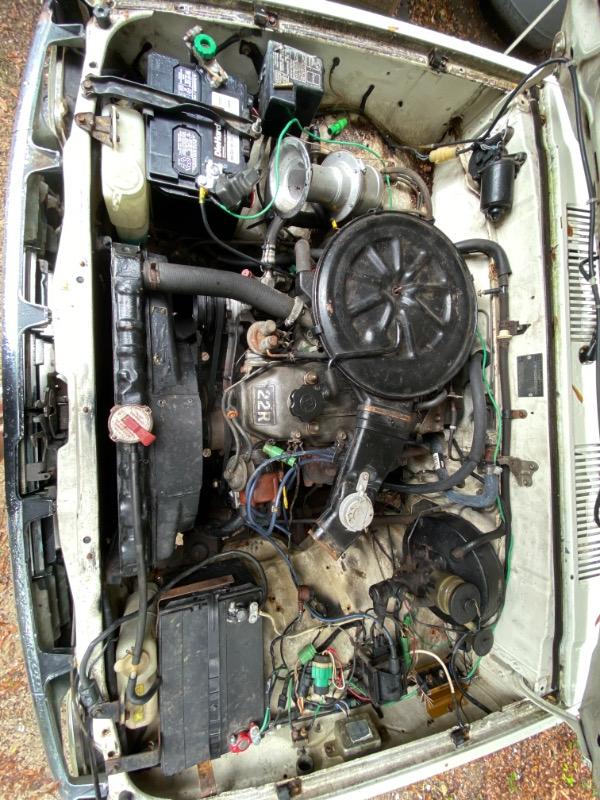

Stormtyler1984dolphin Posted November 12, 2020 Author Posted November 12, 2020 This is what it looks like under the hood if it’s helpful to anyone Quote
WME Posted November 12, 2020 Posted November 12, 2020 Really an Ooga horn!. Anyway you have a diode isolator, its the gold box by the clutch master cylinder. Get your volt meter and with the engine running the center post of the isolator should have 14v+ on it. Thats the alternator voltage. Less than 13 and alternator is not really good, less than 12 and its toast. If you get a bad reading check the actual output of the alternator, you could have a bad wire. The other 2 posts should have what ever voltage is on the center post - about .7v. One of those posts goes to the truck battery and the other to the house battery. So check the voltage on the posts and on the + of each battery. It should be the same. Grounds are just as important the the + leads. I also see a auto reset circuit on the house battery charge line check the voltage in both sides of it. Let us know what you find Quote
Stormtyler1984dolphin Posted November 12, 2020 Author Posted November 12, 2020 5 minutes ago, WME said: Really an Ooga horn!. Anyway you have a diode isolator, its the gold box by the clutch master cylinder. Get your volt meter and with the engine running the center post of the isolator should have 14v+ on it. Thats the alternator voltage. Less than 13 and alternator is not really good, less than 12 and its toast. If you get a bad reading check the actual output of the alternator, you could have a bad wire. The other 2 posts should have what ever voltage is on the center post - about .7v. One of those posts goes to the truck battery and the other to the house battery. So check the voltage on the posts and on the + of each battery. It should be the same. Grounds are just as important the the + leads. I also see a auto reset circuit on the house battery charge line check the voltage in both sides of it. Let us know what you find Hahaha the previous owner put it in! It definitely adds character and people love it! Alrighty, it’s raining again here so once it stops we’ll fire it up and see what those spots are read. Thank you! Quote
Stormtyler1984dolphin Posted November 12, 2020 Author Posted November 12, 2020 7 minutes ago, WME said: Really an Ooga horn!. Anyway you have a diode isolator, its the gold box by the clutch master cylinder. Get your volt meter and with the engine running the center post of the isolator should have 14v+ on it. Thats the alternator voltage. Less than 13 and alternator is not really good, less than 12 and its toast. If you get a bad reading check the actual output of the alternator, you could have a bad wire. The other 2 posts should have what ever voltage is on the center post - about .7v. One of those posts goes to the truck battery and the other to the house battery. So check the voltage on the posts and on the + of each battery. It should be the same. Grounds are just as important the the + leads. I also see a auto reset circuit on the house battery charge line check the voltage in both sides of it. Let us know what you find Oh actually another question. So the center post is for the alternator but there isn’t a wire that goes from the alternator to the post...should there be? The alternator is a Chevy one wire and the wire goes directly to the + lead on the car battery Quote
Stormtyler1984dolphin Posted November 12, 2020 Author Posted November 12, 2020 Alright so with it running the center post reads about 12.1 and the auxiliary battery reads 15 (but we were still plugged into shore power) and the car battery side reads about 12.2 so does that mean it’s the alternator?? Quote
WME Posted November 12, 2020 Posted November 12, 2020 1 hour ago, Stormtyler1984dolphin said: Oh actually another question. So the center post is for the alternator but there isn’t a wire that goes from the alternator to the post...should there be? The alternator is a Chevy one wire and the wire goes directly to the + lead on the car battery OH yes, from the alternator. The way things are now, what is the voltage on the truck battery when the engine is running? If the alternator is connected directly to the truck battery it should be charging like a normal truck no RV stuff involved...🤡stupid thought... truck battery-passenger side, house battery-drivers side. Things to check use your volt meter in the OHM function. On the isolator measure from the center terminal to one of the other posts...then reverse the leads and measure the same thing. You should have continuity in one direction and not the other (diode). Then check the center to the other post, again same thing continuity one way. Quote
Stormtyler1984dolphin Posted November 12, 2020 Author Posted November 12, 2020 51 minutes ago, WME said: OH yes, from the alternator. The way things are now, what is the voltage on the truck battery when the engine is running? If the alternator is connected directly to the truck battery it should be charging like a normal truck no RV stuff involved...🤡stupid thought... truck battery-passenger side, house battery-drivers side. Things to check use your volt meter in the OHM function. On the isolator measure from the center terminal to one of the other posts...then reverse the leads and measure the same thing. You should have continuity in one direction and not the other (diode). Then check the center to the other post, again same thing continuity one way. Hm okay gotta wait for the rain to stop might wait until tomorrow to figure things out Quote
