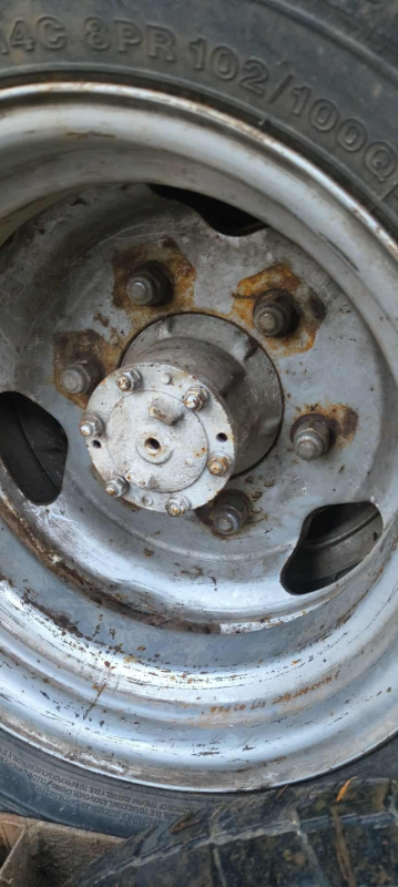

Jac97368 Posted December 10, 2025 Posted December 10, 2025 (edited) The website doesn't have any information. Did anyone ever get a set made? Edited December 10, 2025 by Jac97368 Add photo. Quote
fred heath Posted December 10, 2025 Posted December 10, 2025 Would be very expensive. I carry two spare tires just to be safe. Quote
extech Posted December 10, 2025 Posted December 10, 2025 just carry a front spare. the rear you can run on one till you get to a shop Quote
