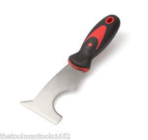

Iflyfish Posted August 26, 2019 Posted August 26, 2019 Excess Silicone removal I found plastic and razor blade scrapers not up to the task of removing excess, hardened silicone sealants. I decided to go with a harder blade and it works great. Pic attached. Box cutter https://www.amazon.com/Stanley-10-099-Classic-Retractable-Utility/dp/B00002X204/ref=sr_1_30?keywords=box+cutter&qid=1566854434&s=gateway&sr=8-30 Blades https://www.amazon.com/WORKPRO-Utility-Blades-Dispenser-100-pack/dp/B015W3AKDQ/ref=sr_1_5_sspa?crid=3CG4TE1NY7OU7&keywords=stanley+10-777+fatmax+locking+retractable+utility+knife+blades&qid=1566854616&s=gateway&sprefix=Stanley+Retractable+Utility+Knife+blades%2Caps%2C520&sr=8-5-spons&psc=1&spLa=ZW5jcnlwdGVkUXVhbGlmaWVyPUFUU0xFR0RVNkVSNkUmZW5jcnlwdGVkSWQ9QTAxODU0MjkyRUY5Q0xJTzJWVVE3JmVuY3J5cHRlZEFkSWQ9QTA0OTA5MTgxVDhWN0JKRURUMzY2JndpZGdldE5hbWU9c3BfbXRmJmFjdGlvbj1jbGlja1JlZGlyZWN0JmRvTm90TG9nQ2xpY2s9dHJ1ZQ== Scraper Handle I found the yellow handle at Home Depot Quote
