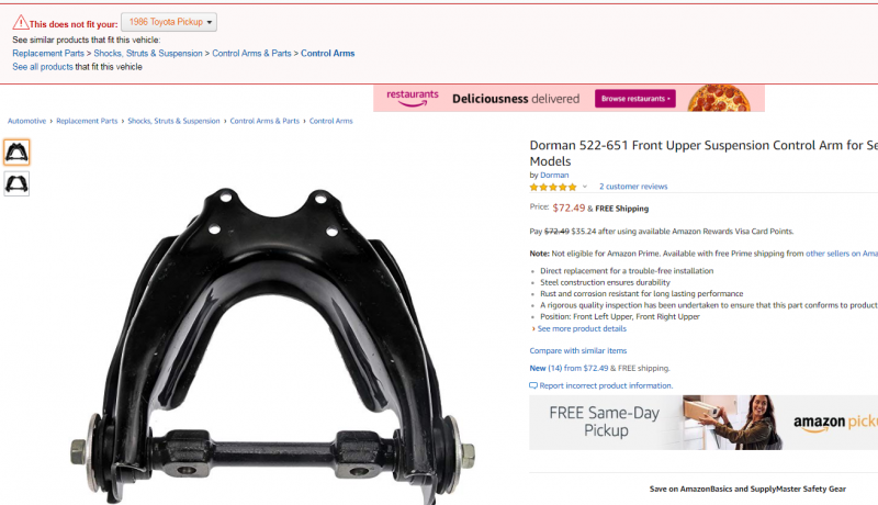

Ctgriffi Posted April 3, 2019 Posted April 3, 2019 What about just replacing the whole thing? That's what I'm planning to do on mine, upper and lower. Those bushings seem like a pain to deal with, and the new control arms have 'em already. Upper: Dorman 522-651 Quote

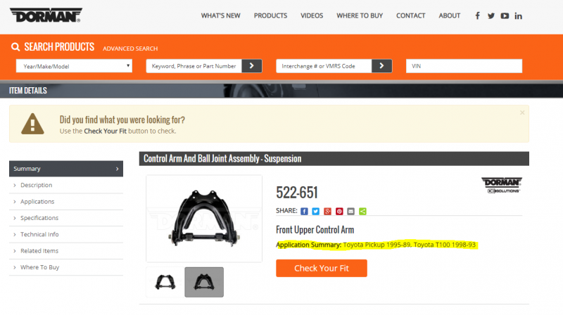

mpanzar Posted April 3, 2019 Author Posted April 3, 2019 Im curious about how to do it properly, but i have considered that. Also, does that part fit? for whatever reason rockauto and amazon do not think that its a proper fit. Regarding the lower control arm bushing, that one is pretty easy to pull. I've got details on the tool i made if your interested. Quote
mpanzar Posted April 3, 2019 Author Posted April 3, 2019 I just check dorman and its intended for 89-95 pickups Quote
Ctgriffi Posted April 3, 2019 Posted April 3, 2019 defrag4 confirmed that the Dorman 522-651 worked fine on his '91 Itasca in this thread: Quote
