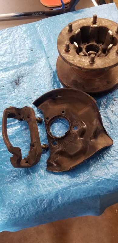

okay. So I have the pads and rotors for the front that I'm going to replace myself, and someone replace the shoes in the back already, but in replacing the shoes I found out that I'm definitely going to have to replace the drums as well.
When I call autozone, they give me a part number 3555 for 298 mm
I can't tell if that says 298 mm in there, I can't imagine what else it would say
I am told that the part number I quoted above doesn't match and so I'm curious. I have a 1983 sunrader, by the way
You have an 83 Sunrader but your rear axle is not from that year. 3555 is going to get you a 5 lug drum not 6 with the larger center opening. I need to know if your rear wheels are 3 hand holds or 6. Since I don't know what year axle was used that will help me pin point the drums needed. Do you have a picture of these drums? Hard to believe someone would replace the shoes and not replace scored drums
Okay, I was afraid of that.
Very glad I checked
Here are some pictures, they weren't changed, because I didn't have the parts and was stuck down in Florida and there was enough drum for me to make it home and just replace the drums here. It had thrown a shoe on the left side and with the new shoes it was driving acceptably
I don't know what three or six hand is it's six lug nuts in the back here's a picture of it with the wheel off if that helps?
