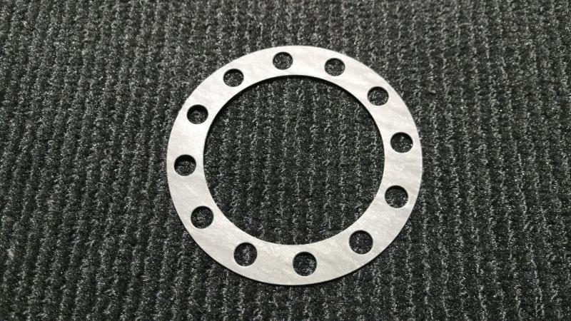

On 2/1/2019 at 5:10 PM, defrag4 said:
Axle Shaft Hub Seal/Paper Gasket - Toyota Part No.: 43422-60040
For this part I've been buying seals that are often indicated as "incompatible" with a 2wd pickup (supposed to be for a 4x4), but they seem to work just fine and are available. These have more holes than is needed but the have the right diameter and width and all of the bolts and pins line up with the holes.  I was wondering if this is what other folks are using or is there a good source for the 'proper' ones?  I see them listed on ebay for $10 a pair shipped as "Genuine Hub Gasket 1975-1998 Toyota LandCruiser Pickup 4Runner FJ40 4WD 4X4 pair"
