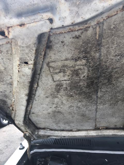

ikm1520 Posted October 25, 2018 Author Posted October 25, 2018 Hey Linda, In a previous post I had seen people talking about axel ratios to make sure it lines up correctly for the body. Are there problems I would run into or specific questions I should ask the salvage yard. I tried to find the info from my truck but sadly it looks like someone painted over the plate in the engine housing. Quote

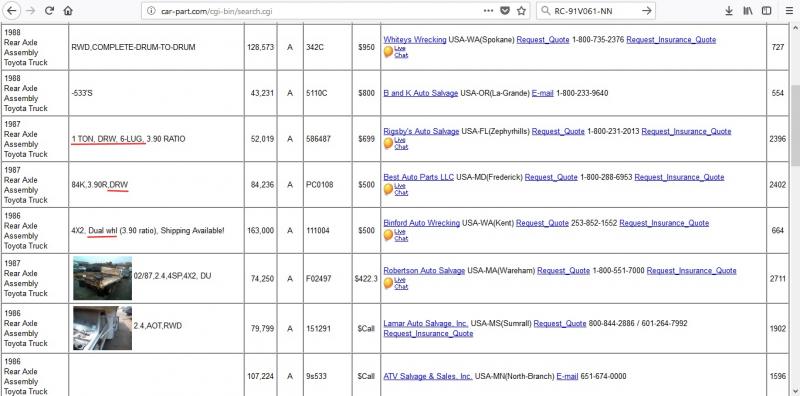

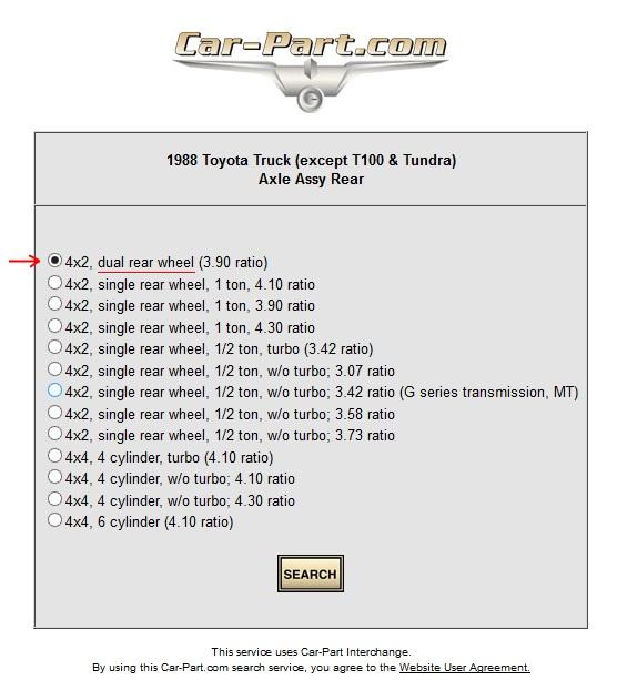

TigersRreal Posted March 18, 2019 Posted March 18, 2019 On 2/5/2019 at 10:35 AM, linda s said: In case you might still be interested in a Toyota axle these places have some showing up on car-part.com Premier Auto Recyclers USA-VA(Warsaw) Request_Quote 804-394-2000 Request_Insurance_Quote 50 1990 Rear Axle Assembly Toyota Truck IN TRK $1000 Joe's Auto Parts USA-VA(Carrollton) Request_Quote 1-757-238-2240 / 1-800-238-4992 Request_Insurance_Quote 70 1990 Rear Axle Assembly Toyota Truck 3.0L,AT N0603 $Call American Auto Salvage USA-VA(Woodbridge) Request_Quote 703-494-7184 / 540-825-2571 Request_Insurance_Quote 74 1992 Rear Axle Assembly Toyota Truck 3.0L,CATO,RWD 100,001 A QF6914 $750 P & D Automotive USA-NC(Pelham) Request_Quote 1-800-292-3428 Request_Insurance_Quote Hey Linda, what do you search for when you're looking on car-part etc for a replacement rear axle? Let's say it's going on a 21ft - I think you'll need 1) full float 2) 4.10 gear ratio is ideal 3) length of axle - and from what I've gathered, where the springs rest can be modified at a good shop. What's another ideal? full assembly? Might as well find a good replacement for the driveshaft as well? I'm hoping to purchase a 21ft '84 Sunrader this weekend and might try to source a rear axle on my drive back home! Cheers to all this CA sunshine, -Neil Quote
Derek up North Posted March 18, 2019 Posted March 18, 2019 I would ignore the mention of 3.90:1 ratio. Car-Part.com seems to think that's all that's available. I don't agree with them. I think most DRWs are 4.10:1. Quote
