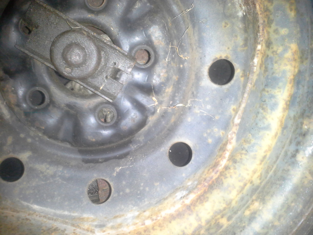

Pretty Interstate Machine Posted September 13, 2018 Author Posted September 13, 2018 Thanks for the tips, @WME and @Derek up North! So, I have a spare, and that's a really good point that I should figure out which one it is so I can figure out what I need to do. Potential noob questions follow: Are you suggesting I find a "friend" that can get truck things, or might work in the industry? Just to make sure I catch your drift... (maybe that's not the best term to use since there will be no drifting in my toyhome ?) Are adapters safe/reliable? Do they put extra wear on the axle? A cursory google search shows me a bunch of people that are like "of course it's safe!" and then you realise they're selling them, and surprisingly performance plus tire is like "5 to 6? pretty much out of the question" - I don't want to start a debate/holy war, just curious if there are any reports of one vs the other. I know all about the debacle and recall with replacing the rear axle and how much of a pain in the behind it was, but that's because the toyota is RWD, right? would it be easier to just swap out my front axle with a 6-lug axle? Thanks for the suggestions, I'll check out my spare and report back on that tomorrow. Quote

Derek up North Posted September 14, 2018 Posted September 14, 2018 I'd estimate your chances of finding a 5-lug spare at around 99%. Quote
Pretty Interstate Machine Posted September 14, 2018 Author Posted September 14, 2018 aaaaaaaaaaand the verdict is: yup, you're right. Quote
