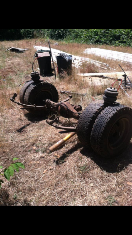

Road warriors Posted July 20, 2018 Author Posted July 20, 2018 Thanks Derrick, I already checked your links tho and they are dead. I do have owners manual for both the rv and the Toyota truck and your rite it’s not much info in there. I am interested in the service manual for the truck tho its $50 on eBay.... I checked the link you sent Linda and it says it’s for an 88 to 95 Toyota truck. Will the config for my 85 be the same ? Thanks for the help everyone. I managed to find myself a one ton dually it’s on its way to me on Saturday from Oregon, including air bags. I plan to fit it on Sunday, is there anything I should consider replacing whilst doing the job I.e leaf spring bushings .. someone mentioned to me I would have to replace u bolts .. ? I’m pretty sure I don’t have to touch the ubolts since I bought the whole rear end. Any advice about the job would be appreciated. I’m not a mechanic but i’ll Give it a go. . Quote
fred heath Posted July 20, 2018 Posted July 20, 2018 New bushings for sure. I hope you have a lift to work with. Trying to get enough ground clearance with jacks only could be a problem. The shackle bolts are often rusted in place and can be a real challenge working on your back. Quote
linda s Posted July 20, 2018 Posted July 20, 2018 The full float axle isn't any different in later years and your 85 has the same frame as my 86 that came with a full float so that manual should work fine for all the ale stuff. Work for the engine too cause they made the 22re for a long time. All the axles Toyota sent out for the recall were 90's axles and they were fitted to older trucks. One thing I want to mention. It looks like the wheels are 6 hand hold wheels. Do you know what year this axle came off of? If it has 6 holes in the rear wheels the drivers side is reverse thread. Only made in 1986. Not a deal breaker but need to know to get the wheels off without breaking studs. Linda S Quote
Road warriors Posted July 20, 2018 Author Posted July 20, 2018 (edited) I’v already started putting penertrating oil on so hoping that will help a little. Unfortunately I won’t have a lift just a trolley jack and jack stands, it’s the way my farther worked before me and it’s the only way i know how ? thanks for the info on the book Linda hope it will be useful in future endeavours also. The rear end is coming out of a 85 yota rv aswell, I have heard of that before also .. I will be sure to look out for it. Thanks ? Edited July 20, 2018 by Road warriors Quote
