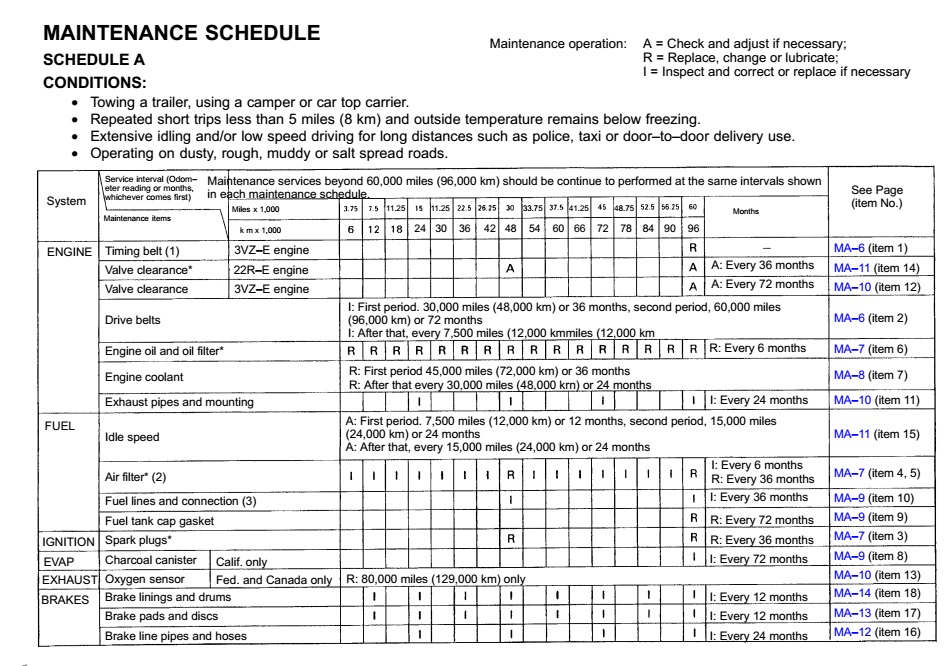

linda s Posted April 12, 2018 Posted April 12, 2018 Yes the shim and bucket can be adjusted and no they don't make noise because they don't get loose they get too tight. Maybe you should have shown him the recommended service schedule. You could have probably downloaded it and printed. Valves are supposed to be adjusted at 60,000 miles. Linda S Quote

Derek up North Posted April 12, 2018 Posted April 12, 2018 Toyota agrees that it doesn't have to be done 'very often'. That's why the Service Schedule calls for it @60k mile intervals and not the 'often' @ 30k miles of the 22RE. As Linda said, unlike the 22RE, the 3VZE clearances decrease and get quieter with miles, so noise is not a good indicator of clearances. Tight clearances will lead to burnt valves. Quote
Badgerbear Posted April 12, 2018 Author Posted April 12, 2018 Thanks for posting that up. I have it printed and will show the mechanic. Well I'm just gonna roll with it I suppose, because I definitely can't afford $1000 on this job right now. I know a guy down the street that got the valve adjustment done on his 3.0 motorhome in Sandy, OR and was really happy with the work. I Will try that, but for now I'm going on my first real road trip! Washington-Colorado-Kansas and back! Quote
