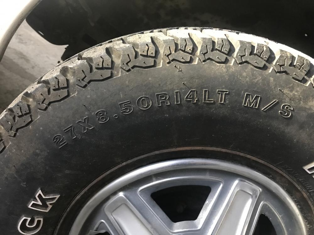

guitarlover519 Posted December 29, 2017 Posted December 29, 2017 Ok guys. I need tires for my chinook Newport. It has 14 inch rims in front, and 15s in the rear. Currently on the front is a oddball size- 27x8.50R14 Rears are 235/75/15 He has load range D all terrain goodyears on the back right now. I can't seem to find a load range D anywhere online. Only light truck tires with 108 load rating. The fronts I can't find load range D at all! Will 185r14 fit in front? Do you think the all terrain tires that are on it now are slowing me down a noticeable amount? What should I do? Haha Quote
linda s Posted December 30, 2017 Posted December 30, 2017 108 load rating is higher than a D load rating so those truck tires would be fine. Why are you running 15 inch rims in the back though. Must be very wide front rims too to fit that tire. Toyota 5 lug rims are cheap if you want to simply switch to 185r14 tires and quite a few of those are available very reasonable. Your Chinook is light enough that single tires with D load is plenty. If you want a little more load capacity because it's the Newport you could go with these https://www.tires-easy.com/205-14/thunderer-tires/ranger-r101/tirecode/TH0309 Great price and more than enough for your rig but you would need new rims, maybe front and back. Don't know if the all terrain is slowing you down but it's definitely costing you gas. Linda S Quote

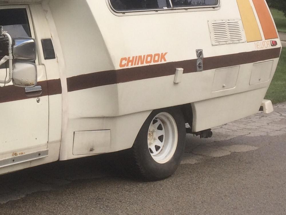

Derek up North Posted December 30, 2017 Posted December 30, 2017 Can you post a picture of the wheels you've currently got installed? Otherwise it's just guesswork trying to figure out what you can install without buying new rims all around. Quote
guitarlover519 Posted December 30, 2017 Author Posted December 30, 2017 Salvage yard says he's got steelies for 40 bucks a piece. Thinking about grabbing those maybe and switching to 185r14. The cool factor of the off road tires is swaying me though Quote
fred heath Posted December 30, 2017 Posted December 30, 2017 Your rear white spoke wheels are generic aftermarket wheels. I'm sure they're probably 5x4.5 (common jeep size). Here are some from amazon with free shipping. https://www.amazon.com/gp/aw/d/B01DVKJCJU/ref=mp_s_a_1_3?ie=UTF8&qid=1514668120&sr=8-3&pi=AC_SX236_SY340_QL65&keywords=14+inch+wheels&dpPl=1&dpID=413kAmTE89L&ref=plSrch Quote

WME Posted December 30, 2017 Posted December 30, 2017 (edited) From the way the tires fit the front rims I think you have stock front rims. 185 tires have a higher rating than what you have and would steer a lot easier. Again a SWAG is some body want more ground clearance for a bit of off roading. Those tires will give you almost 2" more ground clearance. If you don't plan on off roading then 185 on the front and something like a 195/70/15 on the back would work with the rims you have. A thought Toyota 14" rims all the way around would simplify the spare situation. Edited December 30, 2017 by WME Quote
guitarlover519 Posted December 30, 2017 Author Posted December 30, 2017 41 minutes ago, WME said: From the way the tires fit the front rims I think you have stock front rims. 185 tires have a higher rating than what you have and would steer a lot easier. Again a SWAG is some body want more ground clearance for a bit of off roading. Those tires will give you almost 2" more ground clearance. If you don't plan on off roading then 185 on the front and something like a 195/70/15 on the back would work with the rims you have. A thought Toyota 14" rims all the way around would simplify the spare situation. DARN it! I had made my mind up I would buy new rims for the front and run 185s in the front, and then do a nice knobby in the back till I read your comment. I really should get a spare, especially considering I don't have a dually! Quote
guitarlover519 Posted December 30, 2017 Author Posted December 30, 2017 1 hour ago, linda s said: I too am easily swayed by an aggressive tread. Maybe costs some gas but look fabulous. The General Grabber At tire is available in a 14 inch size and has a C load rating so enough for your little rig. Not too bad price wise either. Just a bit over a hundred and lots of places with free shipping and no sales tax like this. Very reputable seller. Thousands of sales and no bad feedback. https://www.ebay.com/itm/4-NEW-27x8-50R14LT-General-Grabber-AT2-95Q-C-6-Ply-OWL-Tires-/302534691411?_trksid=p2385738.m4383.l4275.c10 Just saw the wheels Fred posted. Nice and crazy good deal Linda S These were the ones I was gonna get till I thought about the spare issue ugh Quote
WME Posted December 30, 2017 Posted December 30, 2017 Check your front rims carefully they should be stamped with the wheel size. Something like J14x5.5. If thats what you have, your current front tires will not wear correctly. The 8-5" tires needs a 7" wide rim. Suggestion. Buy two stock rims and put new 185s on the front. Take the front tires and rims put then on the back and sell your rear rims with the tires to the Jeep guys. You will have a bit of a stink bug attitude. When the rears wear out then get the 185s for the back Quote

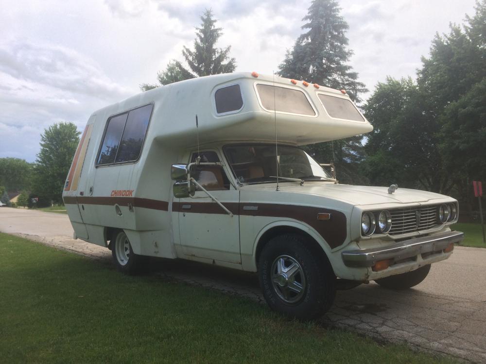

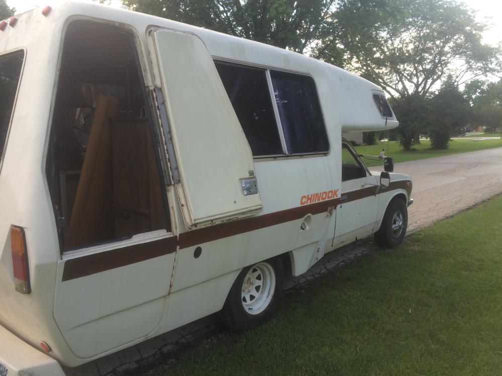

WME Posted December 31, 2017 Posted December 31, 2017 Take off the hubcaps and take a photo. Lets see what you got. I THINK the factory rear tires were something like L60x14. Of course that size is obsolete. The fronts were something like 7.50x14, thats obsolete too. Quote
fred heath Posted December 31, 2017 Posted December 31, 2017 (edited) 8" wide rims on the front is crazy. I could see them on the back but not the front. With manual steering and those rims your arms must get tired steering from a dead stop. I suspect your front rims were originally on the back. If you like your current fronts, switch them to the back(if they will carry the load) and put new wheels and tires on the front. Either way, I'd get those 8" rims off the front. They were designed for the back. Edited December 31, 2017 by fred heath Quote
Derek up North Posted December 31, 2017 Posted December 31, 2017 Here's what I'm seeing:- Front wheels look like they're the original Toyota rims hiding behind the hub caps. That would be either 5"x14" or 5.5"x14". The currently fitted 27x8.50x14" tires have a recommended rim width of 6"-7.5". Rear wheels look like aftermarket 8 spoke rims. Will guess at a 7" width with a 'deep dish' offset. The currently installed tires have a recommended rim width of 6"-7". Here's what I would do, assuming the current tires are in usable condition. Buy a set of 6"x14" 8-spoke white steelies (to match the rear), swap front tires on and be done with it! Oh, and keep one of the current front rims for a spare tire. I have no record of what were originally offered on the Newport, but they were offered with wider singles on the rear. Don't know the offset or diameter. Quote
