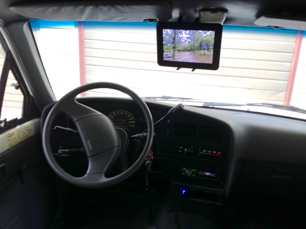

Ctgriffi Posted August 29, 2017 Author Posted August 29, 2017 Finally got everything tested, installed, and in-use while driving, and I have to say that I'm pretty darn happy with it! It's not a perfect solution, but I feel like it's 1000x better than a dummy rearview mirror, pointed at the bathroom (what I used to have). I like the simple installation, the lack of major wiring headaches, and the fact that video gets piped right to my Kindle Fire HD tablet, which I like to bring along in the RV anyway. Also, since it's all fairly modular, it should be easy to replace broken components, or upgrade with new/better. Before I get into details and photos, here's a list of what I used: WiFi camera transmitter: http://a.co/853NJGf Flush-mount camera: http://a.co/g2qDJg5 Windsheld mount for tablet: http://a.co/h2fHGFI TESTING Once I had everything on hand, I used a simple 12V power supply with a standard connector to power up the transmitter for testing indoors (transmitter is supposed to work with 9-30V, according to the specs). The camera is a separate unit, of course, and plugs straight into a handy power connector on the transmitter, so it's all daisy-chained together, and you only need to make one connection to a power source on your rig. The video transmitter connects directly with your device (smartphone, tablet, etc) over Wi-Fi and video is displayed using an iOS or Android app. The app is barebones and kind of crap, to be honest, but it seems to do the job: I left the whole setup running for a few days and was able to receive smooth, consistent video at a distance of about 30-40 feet, with a few stud walls in between. Video quality is VGA (at best!) and the h.264 codec starts to break up pretty fast with a lot of onscreen movement... but, it's plenty of detail for me to see what's going on behind the RV, so I'm good with it. Don't plan on watching any movies with this system. Some of you brought up the question of lag-time, which is a serious consideration. Here's what I experienced: at start-up, I measured lag at very close to one-half a second, which is not bad at all and very usable for my purposes. However, after a few hours, the lag-time seems to increase to close to a full second—not sure if it's a problem with the transmitter or the cheesy app, but it's not ideal when you're in traffic! Still, I figured out that a power reset of the transmitter brings you back to square one pretty quickly, which is very easy to do from the driver's seat if you've got it all wired to the clearance lights: just flick 'em off/on. Last thing I did with testing was make sure that my fully charged Kindle (which is an Android-y platform) would successfully display the video signal for five hours straight, without dying. This is about the max drive-time that we ever do in our Warrior, so I wanted to be sure that the battery was up to the task. INSTALLATION Drilled a hole straight through the middle of the upper center clearance light into the back of the over-sink bath cabinet. I tied the transmitter power cord into the clearance light circuit. From the inside, using the hole saw provided with the camera kit, I drilled another hole at the base of the cabinet, straight out the back of the RV. Then, I used a box cutter to cut a slightly larger, square opening in the back of the cabinet, around the camera hole, removing the luan ply and foam insulation, to make room for the camera's inner retaining ring. The camera is inserted from the inside, followed by a threaded finish ring on the outside (extra pair of hands recommended). After the camera was installed, I plugged everything together and... it worked. A few zip ties and strips of velcro were used to tidy things up, with plenty of room left for towels, etc. in the cabinet. The rearview mirror came down easily with a few screws, and I attached the suction-mount to the top of the windshield, where it holds the tablet very securely as a virtual rearview mirror. (This post is getting too long, so I'll add some photos in the next...) Quote

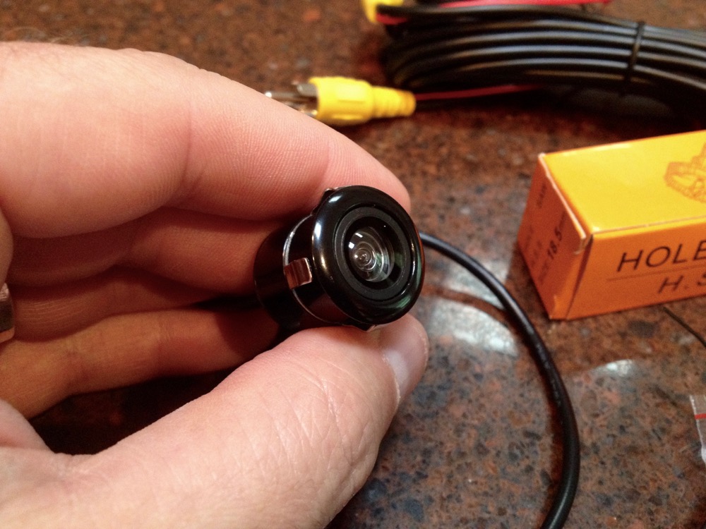

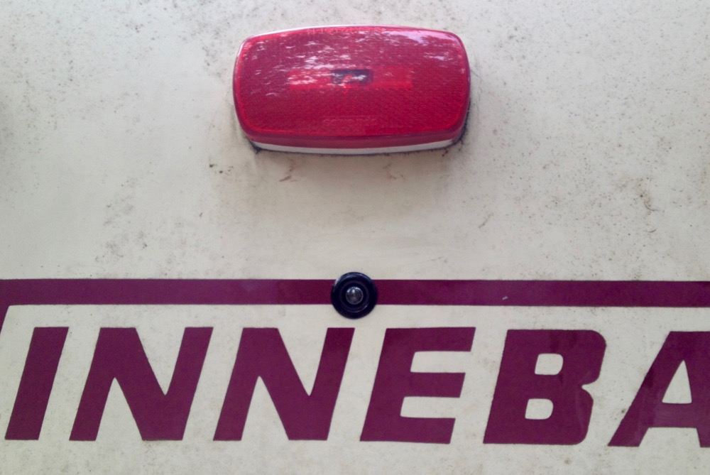

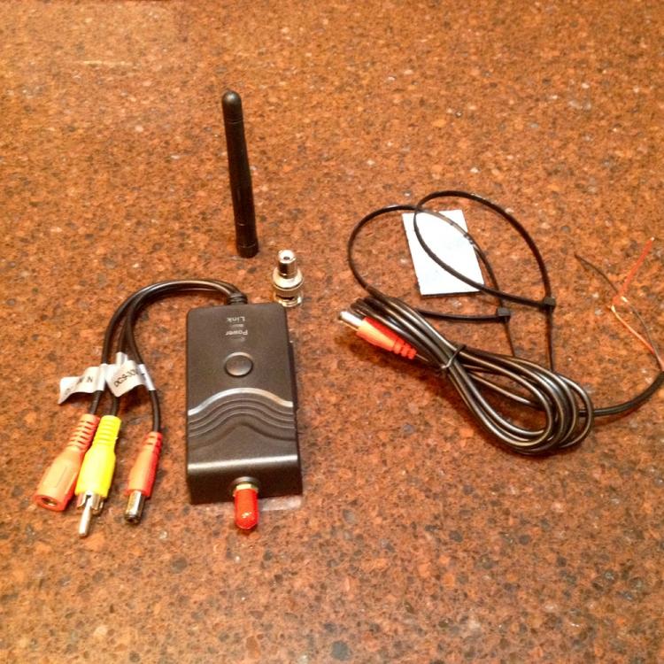

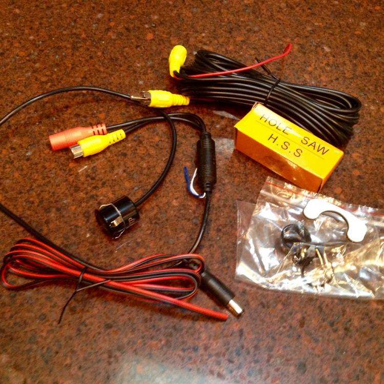

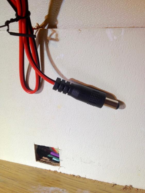

Ctgriffi Posted August 29, 2017 Author Posted August 29, 2017 (edited) Transmitter Kit Camera Kit Camera Close-Up Holes Inside Cabinet Camera Installed Rearview Camera Display A Few Thoughts The camera I chose has two small jumper wires that can be clipped for add'l functionality. I cut the "blue wire" to reverse the image, to match the standard behavior of a rearview mirror. If I'm being real nitpicky, I wish the camera were pointed a few degrees further down, but there's not much you can do to alter that angle when you're dealing with a flush-mount setup (other than mounting it on a different surface, of course). Still, it's not a big deal; I can see plenty. In the app, you can change the transmitter SSID to whatever you wish... I went with "Warrior." Edited August 29, 2017 by Ctgriffi so much to say Quote
