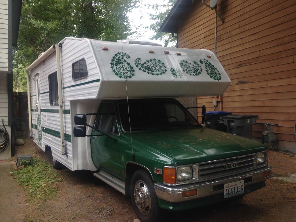

1988dolphin Posted July 22, 2017 Posted July 22, 2017 Morning All I am in the process of making the decision to drop gearing from the stock 4.10 to 4.88. I love my RV but my biggest fear when I drive my 1988 21 foot Dolphin / 22RE / automatic is to stall out on a steep hill. It has happened to me once and I needed a tow truck to get to the top. Truth be told I should not have attempted that hill that night. I should have just pulled over. Yet I did not and a lesson well learned. Since then I have greater respect and understanding of the limitations of the vehicle and have adjusted my driving style accordingly. I added a tachometer and ATF temperature gauge and drive with OD locked out. I am completely happy driving 55 MPH on the flats. I just want to be able to drive with a bit less concern about what may lie around the next corner on the road. Since that time I have made the climb up to Crater Lake, (top of the torque curve in first gear), and countless other 5000 and 6000 foot climbs with 4.10 gears. How much of a difference in real life driving does 4.88 gears make? I have spent hours on line using gear ratios calculators so I think I understand the numbers. What I really need is to hear from folks who have actually made the gearing change to 4.88. Were you happy with the change? Was it worth the effort? Where there unforeseen effects of the gearing change? If you were to do it all over again would you do it again? I welcome your feedback. Quote

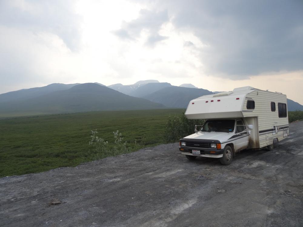

GinjaTurtle Posted July 24, 2017 Posted July 24, 2017 Hi. I just made this change and I love it. I have a 1988 Odyssey 22 foot RV. It is the largest and probably heaviest of these units. I drove it around for about a year on the 4:10's and had more than one occasion where it just wouldnt go up some hills. In April of this year i swapped a 4:88 differential (from a 95 4-runner, $375 from a wrecking yard). My mechanic had it in in under 4 hours and I had no problems with the install afterwards. Just after getting this done, we took a trip to Alaska (all the way to Prudhoe Bay). We drove from Everett, WA through Vancouver and Squamish and past Whistler. In there were many 12% and 13% grades. I am certain I would not have made it up without the lower gears. When it drops down in to first now it will go up just about anything. As for top speed, I have the automatic and I could hardly get out it in to overdrive before. Now I can cruse along in overdrive at 60 quite comfortably. One thing to know is that you need to adjust the speedometer. You can go through old posts on here and find Commercial Speedometer. That guy had mine in my hand 2 days after I ordered it for $80. It's been really nice to have a speedometer/odometer that works properly. You also need to disable the overdrive high altitude lockout switch under the dash. You can just unplug it and jump the two wires together with a switch between them (I have a switch zip tied to the gearshift). All in all I highly recommend this change. Be sure you go to the 4:88's, 4:56 would not have been enough. Quote
