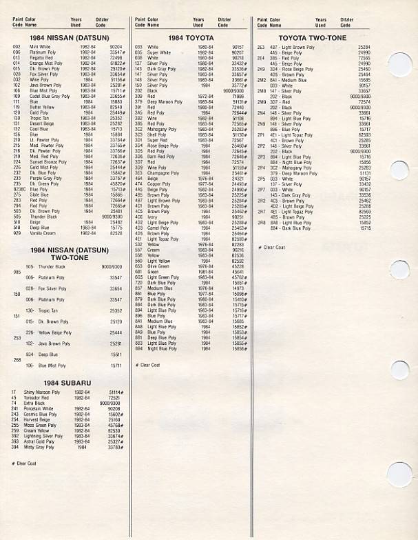

Derek up North Posted June 7, 2017 Posted June 7, 2017 Ditzler lists 3 different 'white' paint codes for 1984 Toyotas:- 033, 035 and 038. Just a guess, but '035 (Super White)' sounds like what I would call 'Refrigerator White'. P.S. I would consider Ditzler as an 'Expert'. Also, there is no indication in the above chart if all (or none ) of the 'whites' were used on the Trucks. Quote

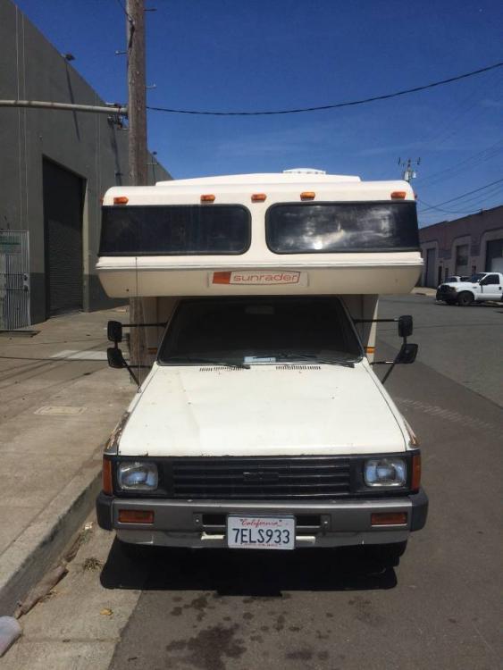

sweetleon Posted April 25, 2018 Posted April 25, 2018 The rest of the vehicle isn't very shiny, so I think it'd look out of place if the hood was shinier than the rest. Here's a photo of the hood and the vehicle overall. As you can see, it's not very shiny. Quote
Derek up North Posted April 25, 2018 Posted April 25, 2018 So you just want to paint the hood and want the 'gloss' to match the rest? I'd just grab a rattle can of the colour Linda mentioned above. Forget a 'clear coat' The cabs weren't originally painted with 'base coat/clear coat' anyway. Quote
linda s Posted April 26, 2018 Posted April 26, 2018 The color I mentioned is for the fiberglass coach. It's a little yellower than the truck. I wouldn't worry about using gloss at all. Any finish is a buffer pad away from a match. Linda S Quote
