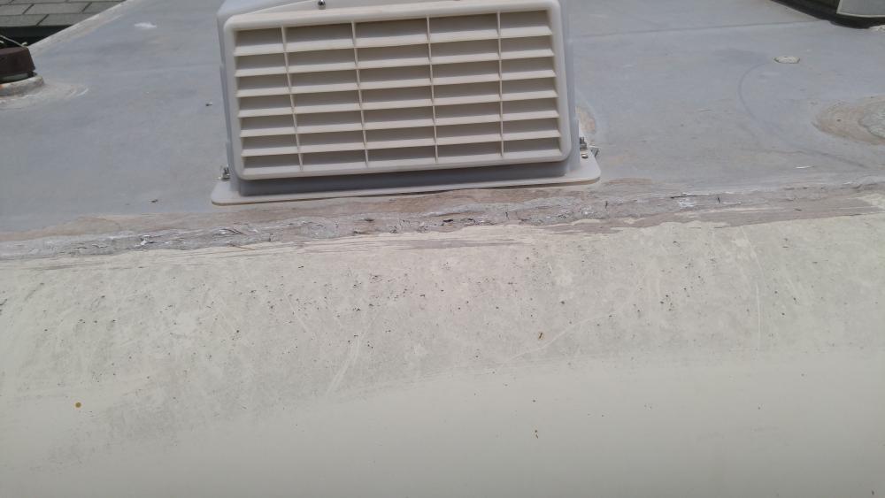

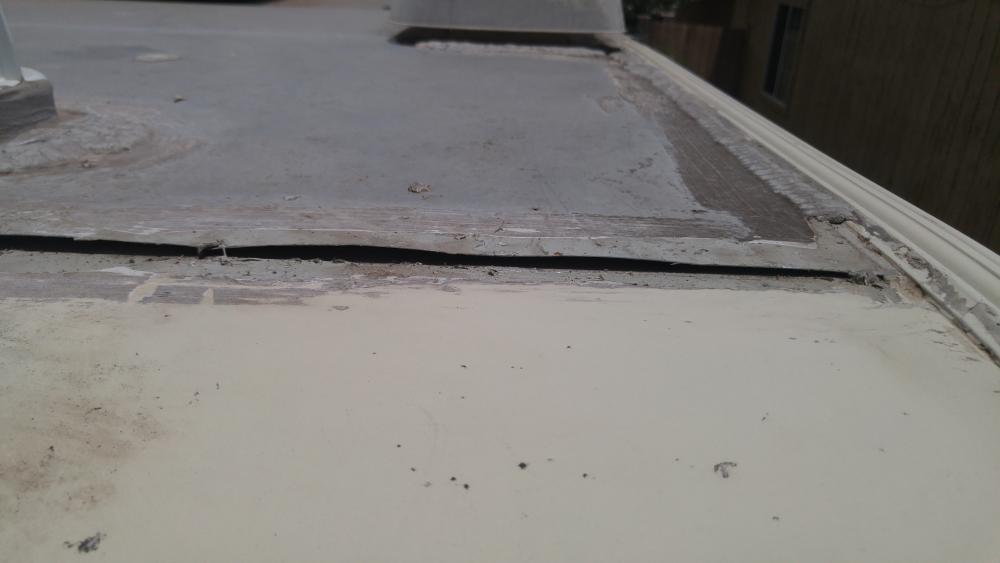

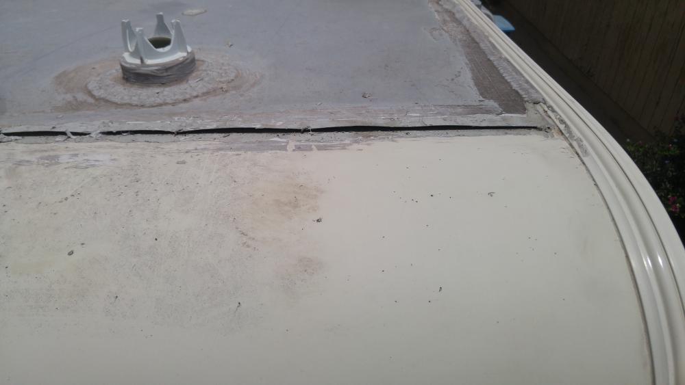

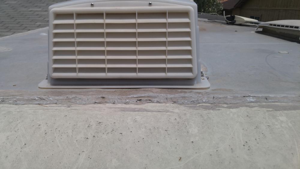

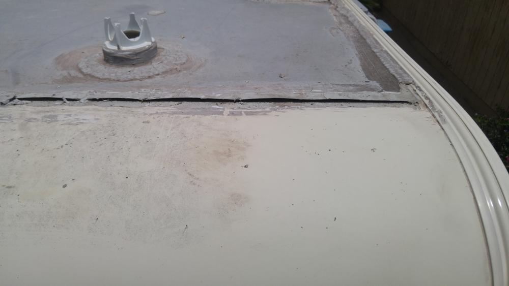

  1. Hi all, so I've been busy redoing all of the seals on the exterior of my Minnie Winnie, and one that needs to be redone is the where my metal roof meets the fiberglass on the rear of my coach. I noticed some cracks in the original sealant so I've started scraping it all off as opposed to trying to get enough lap sealant over the top to seal down into the cracks. I'm concerned about the separation here between the sheet metal an the fiberglass. It looks like it was originally stapled together and the staples are no longer holding. There is a piece of wood that runs the width of the coach almost where the seal is, so the only solution I've come up with is to put some screws through the roof, but I know that's not ideal, putting new holes through the roof and all. Then, I will put a new layer of lap sealant over the seam, and some eternabond roof tape over the lap sealant. Does anyone else have experience with this, and/or advice? Thanks!!
