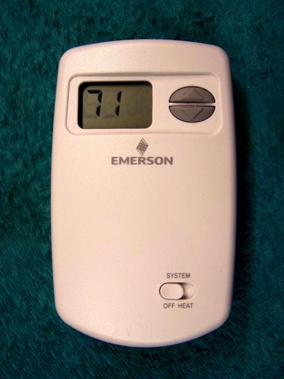

  4. Very simple upgrade to the old-school, round thermostats that you find in most vintage RVs. Much easier to read/set accurate temps and takes less than 5 minutes to do the swap: 2 wires and 2 mounting screws. Emerson 1E78-140 (found mine for $18 on eBay w/shipping).
