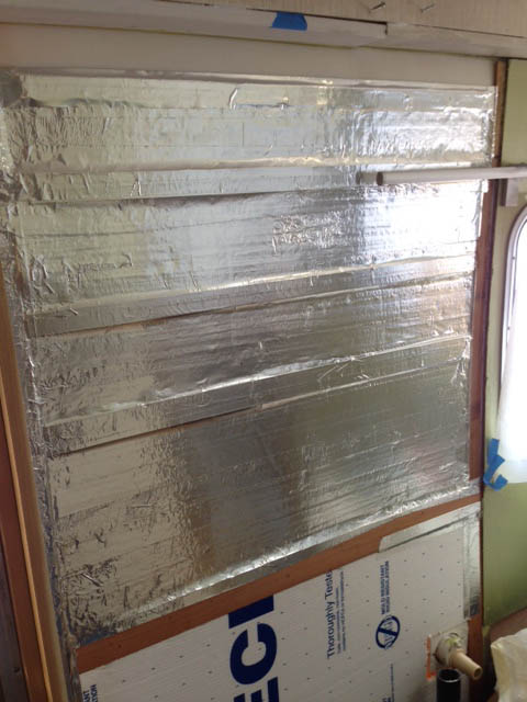

  15. Finished epoxying in more blocking against the fiberglass in my Sunrader. It is on the wall that has the cabinet for the stove and sink.
    I have new blocking along the horizontal areas where the bottom of the upper cabinets are secured plus a couple of strips to secure things like magnet bars, towel holders, plate racks, etc.
    After I was done adding the new foam board insulation that has foil facing against the fiberglass shell I added a layer of aluminum tape over the foam board and the blocking that faces towards the stove. I am wishing I had done that to all the foam board in other wall areas I previously closed up as it is very easy to do.
