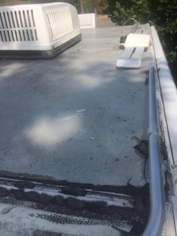

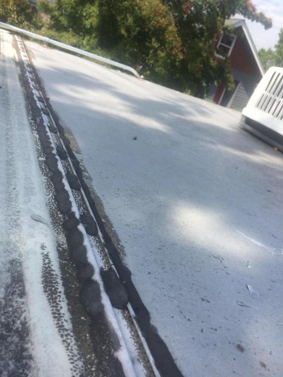

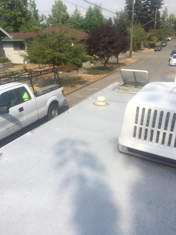

Thanks WME, that's some of the answer I was hoping for.
I went up on the ladder today and took a closer look- it appears that the roof is just metal with no coating on it. That appears to be in good shape, but I don't know how to judge the seams.
I've attached more pictures in case anyone wants to offer some more guidance.
Thanks everyone.

Never easy to take pictures of a roof to show folks the level of detail for informed feedback. In general, any 30 year old bare roof is begging for a good coating.
Here, the question is - what are those dimples and spots that decorate the surface? Shallow pits or through holes?

All of the dimples and spots seem to be just shallow pits. No cracks or through holes as far as I can tell. The previous owner gave me the impression that it spent a fair bit of time garaged during his and the first ownership (I'm the third owner).
With that information, what should I be buying and slopping on?

If a pit has white glueish thing applied to it then its an attempt to fill a hole or crack.
Clean well with a good roof cleaner, pretty much to get a shiny surface, you do this once in an eternity, dont skimp on cleaning. Add a couple layers of a good elastomeric roof coating, as instructed by package, on a warm afternoon.
Members swear by different brands of elastomeric roof coating, everyone from rustoleum to koolseal,snowseal and what not makes a version. Pick the one you like most recommended here by doing a roof coating search and checking on what and why they say about it and whether it applies to you.

Hey Matt on my Granville I had the original bare metal roof and the seams looked like yours. I decided last year to reseal and paint. It was by far the hardest project I’ve done on Grannie! I removed the rear metal piece that covers the rear seem and completely cleaned the area. I put eternabond tape over the seam are reattach the metal strip with much larger SS screws. Put dicor lap sealer over the new screws and replaced the rubber inset with new. Then covered all the edges with lap sealant. Did this all around the roof line. Also cleaned and reapplied lap sealent around all vents. Completely prepped the bare roof and applied a product called Snow Seal. 3 coats. I then applied more eternabond tape to the front seam. Proper prepping is the key!! The big differences I noticed was how much cooler the inside is now how much quieter it is when it rains! Highly Recommended and Good Luck!
