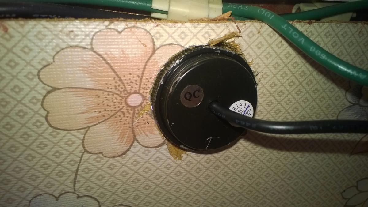

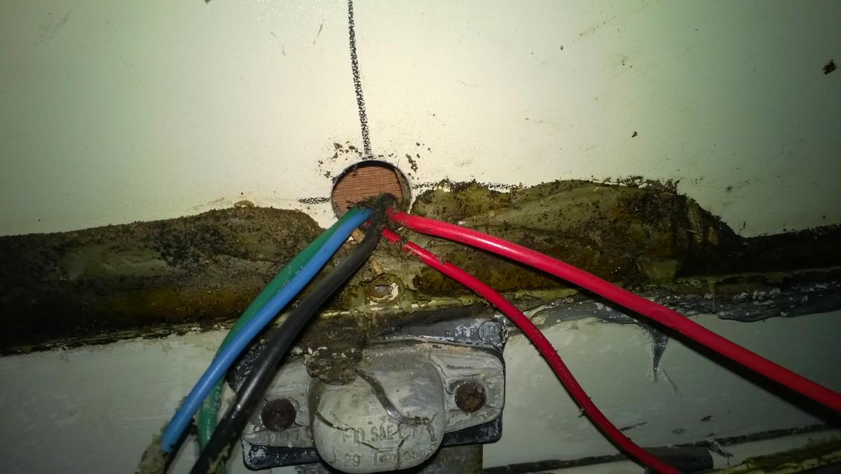

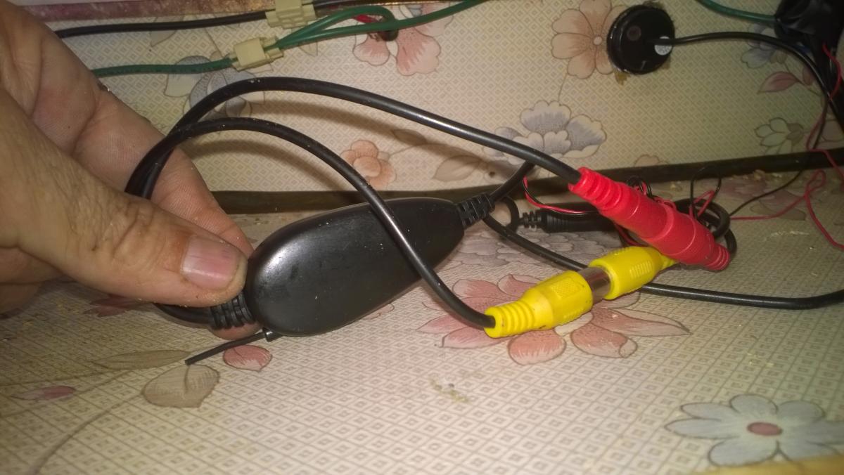

  5. I was messing around with old camera & power it off running lights that had a bad & short connection the + wire broke off solder and fell inside rv..
    so I took off kitchen cabinet sub wall to get to running light wires to pigtail & fix No-Go it was the running light that was dead center inside of wall separating bathroom & kitchen..No big deal..
    Drilled a hole for new wires & spliced into exciting running lights

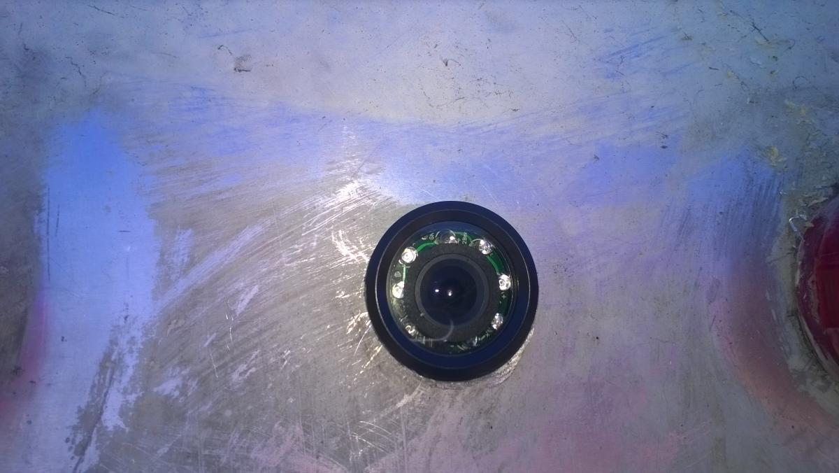

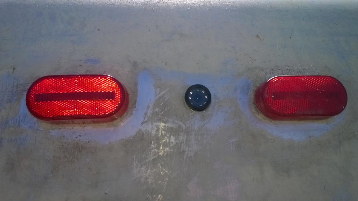

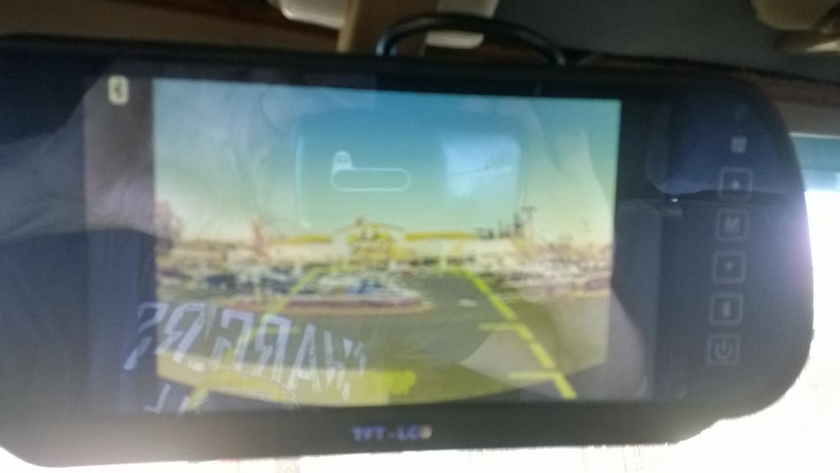

    & got me thinking why not have backup camera & all wires tucked away inside cabinet sub-wall for a neater look outside & not running wires & rca video cable all over the place..
    So I went to Fry's and bought a backup 170* camera that is flush mounted with rv came with its own drill bit for easy install $45w/tax

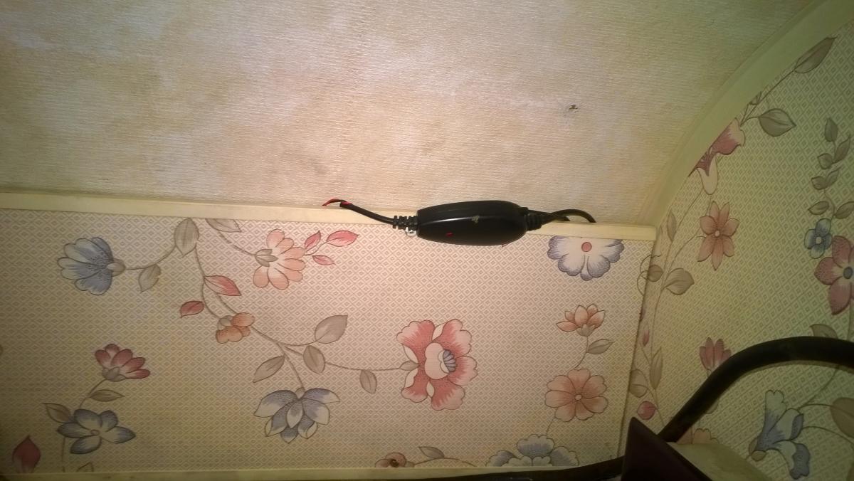

    to go wireless I bought a fm 2.4gh video transmitter & receiver ( http://www.amazon.com/gp/product/B00DOQAGO2/ref=oh_aui_detailpage_o01_s00?ie=UTF8&psc=1) not blu-tooth :) fm signal works better//for me//
    installed transmitter outside of sub-wall for better reception & installed receiver under dash..
    works good & better picture than my rca cable...

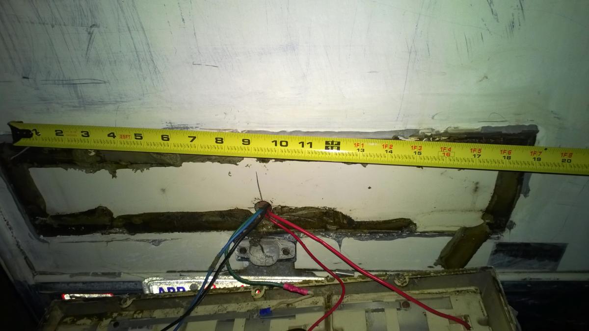

  6. I will update pics hopefully back of rv will be painted asap so it will look nice and clean
    the price is right at $43 for pair
    should be an easy install :)
    They are very nice looking. Can't wait to see a photo of them installed on your rig. I do want to replace my tail lights next year. I have a different opening size but that can be worked around. I have to make a custom base anyway as my 1980 Sunrader does not have a flat surface to mount the lights on. Even the original lights used on it don't fit properly without 3 layers of black butyl tape at the outside edges.
  7. yeah it should not be hard to patch the holes
    and my options are wide open:)
    Your tail lights are the old Bargman 1400's. Nothing made today is quite so long. Closest is the Bargman 84 series triple long but it's a recessed light and needs a hole. I have never seen the 1400's surface mounted before. If your going to paint anyway filling a few holes isn't a big deal. I'd say your light options are wide open since you've got to make some changes anyway. I'd look for surface mount and pick from there.
