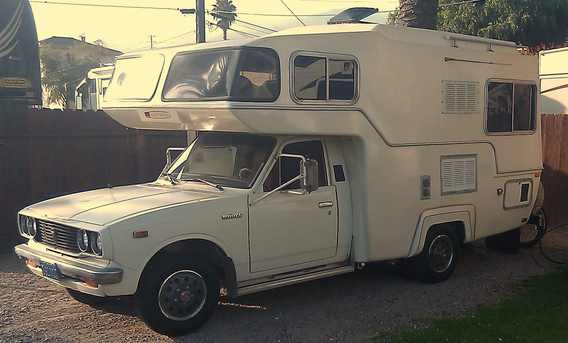

  1. Well sold it for $3950 which is what I paid plus the rebuilt transmission and clutch. I thought I would hit at least 5 but that's the way it goes. I figure the 20r vice the 22r hurt me a bit as well as the overall age vice an 80's. Shaking it off, deploying and then returning to update you folks on hopefully my chinook 4x4 project....
  2. I got my orders and am going overseas in a couple of months so it's time to let this project go http://cgi.ebay.com/ebaymotors/ws/eBayISAPI.dll?ViewItem&item=160593572950 I plan on getting into a chanook and completing a 4x4 conversion when i get back. I know the 1 8 footer is small but i want to go even smaller. My loss is your gain on this one, it's about done and for sure ready for a trip right out of the gate. Thanks for all of your help over the past years.

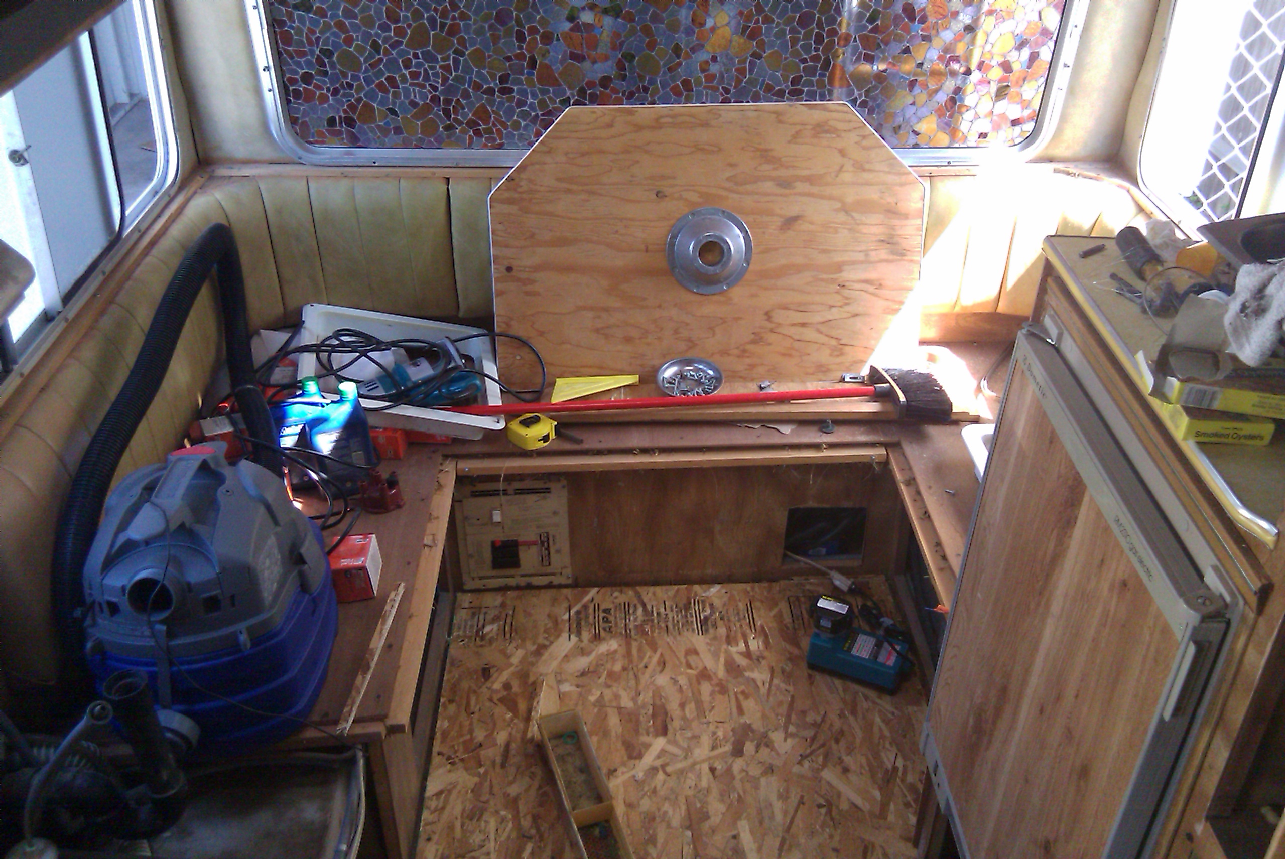

  6. I cut the bad piece out and replaced it with a piece of plywood and then oriented strand board (OSB) glued with construction adhesive and screwed. The floor is tight now. Recommend OSB for torsional strength. ( Though with substantial weather it will start to flake off, the structural integrity will not be impaired. Plywood, even cdx, will delaminate and loose its structural integrity with water. Plywood has structural strength in only one direction, osb in two.)
